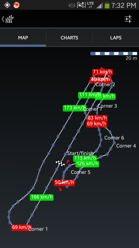

Also, the corner speeds associated with corner 4 and 7 do not show up at all on the video or on the overlay map as you can see in the above pic and video below.

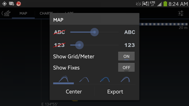

To show accuracy in the map view, the four lower icons select the type of chart shown: lateral, lineal, accuracy, line driven. So please check the third one.
Back to speeds: corner and straight speeds are actually min and max values achieved while driving. In case no min speed is achieved (because you constantly accelerate going though a wide bend), there will be no display. Looking into the video, things look reasonable.

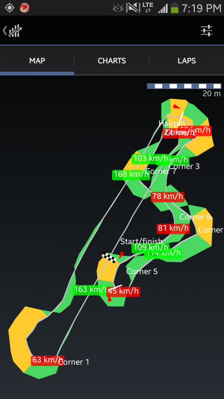

Does this accuracy overlay help explain anything?
I checked the placement of the missing corners and they seem to be spot on.

Corner 5 is not placed well for a split trigger. Saw this when it has been submitted but didn't change it. The problem is it has a driving direction defined just behind the corner and may be ignored. 4 and 6 should be fine. In case you it is important for you, please export this *single* lap to .hlptrl and send it to me. Please add a reference to this thread so I get things associated.

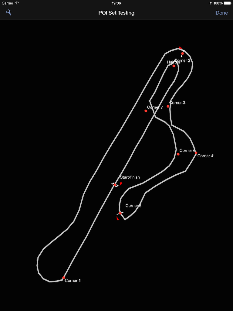

Thanks for sending the sample. Using the Test function (available in the bottom of the POI Set list), you can see Corner 7 is off - which is the reason it doesn't show up. For #4 I'm not sure, it actually looks fine. When I loaded the track set, I saw you had defined it yourself. Please consider moving the splits to some straights - somewhere in the end but ahead of the braking point is the best choice.
