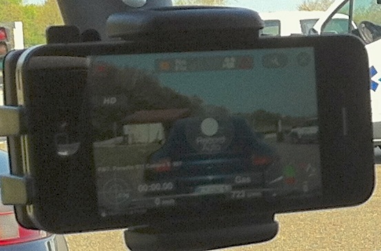

So I connected my Dual XGPS150A and my GoPoint BT1 via BT to my iPhone 4 (using iOS 6.1.3). The connection was shown in the BT menu and when I started HLT (Grand Prix Edition v18.0) by pushing "Timer" and then "Video" it showed all the right data (speed = 0km/h when waiting for the launch, rpms, etc.). By pure chance I took a picture where one can see this (see file attached):
One can see that the OBD data (rpms, etc.) are shown correctly and that the speed is 0km/h when waiting for the launch

Because I suspect that there had been problems with GPS as my picture I uploaded above in this thread seems to show a "NO FIX" message which has to do with the GPS signal, hasn't it?
And i am sure that was not the case when starting my tests yesterday.
