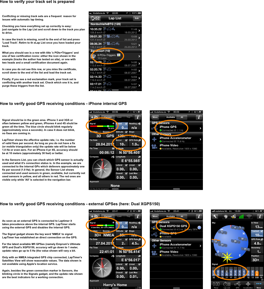

two problems today: #1: doesn't auto-start at stop/finish
Post by gshopper »
First, thanks for writing a great app. I can't wait to get it up and working.
Went to the track today. I had a problem getting the app to start recording video when I crossed the start/ finish line. I set the app to record a video. the message said that it would automatically start when I crossed the start/ finish line. I went three sessions and it never triggered. I went to the finish line during the lunch break, and it worked fine (I was going about 5 mph at the time). But when i was at speed (100 mph) the app never started the video or timer. The start/stop line is midway through the straitaway, so speeds were high.
Interestingly, I had a friend's iPhone with your app, and it worked flawlessly. I don't know his settings, but it was probably the default settings, as he hadn't had a chance to set it up or change any settings.
I set the GPS for wide triggering, but it didn't help. I was getting good GPS reception; the meter was in the green. The phone was mounted on my windshield in the landscape position. I have an iPhone 4 with current IOS.
Any ideas why it didn't trigger?

As you checked the GPS already (I understand you confirm it has been green all the time) it is about the triggers. Please check you have loaded the correct track set and see not any conflicts (red exclamation marks) in the Lap List. As your friend's configuration worked, compare both devices with the Lap List side by side. Check the section for your track - especially the first entry just below the track's section header.
