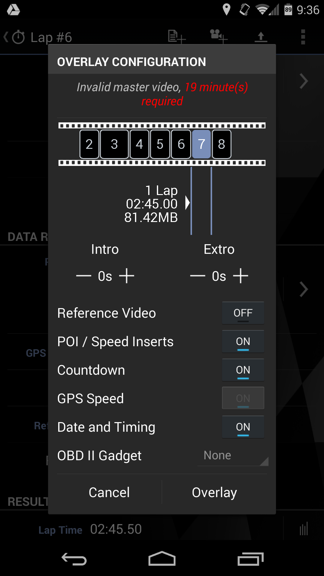

I had 3 runs with Harry's Lap Timer running. The overlay looked great live while lapping. I am able to see the raw video under lap times but am having trouble generating the overlay.
When I click the overlay button I am presented this pop up:
"Number of laps available for multi-lap overlays reduced due to inconsistent sync points. Please adjust the lap's sync point and agree to adjust the full session."
What does this mean and how do I resolve?
After I click OK I get the following screen shot.
I then press okay, and gives me the pop up of having your phone plugged in etc, and press okay. Then nothing happens.
Appreciate the help Harry. Your App was great and worked flawlessly at the track.
Re: LapTimer fails on a Nexus 5
Posted: Sun Apr 06, 2014 5:52 pm
The message simply means there are laps sharing the same video that are not well aligned to each other. In case you want to dive deeper into this, please export the session to .hlptrl and I can give you the exact reason. This will happen in case sync points are changed manually, but maybe it is a flaw too. It is nothing to be too serious about, the bigger issue is the main video linked to your lap seems to be not available (Invalid master video). This needs to be resolved before you can create an overlaid video.

I found the issue with the warning raised and will try to fix it for the next bugfix release. However, as written above, it is actually a warning only and just keeps you from overlaying lap #1 currently. Back to the bigger problem - the "Invalid Master Video". Do you get a preview of this video in Lap Details (i.e. before opening the overlay dialog)? Can you watch / play it?
Posted: Tue Apr 08, 2014 5:55 pm
by bigmillertime
Yes Harry, I am able to preview the video no problem. After pressing overlay there is no response from the software.
