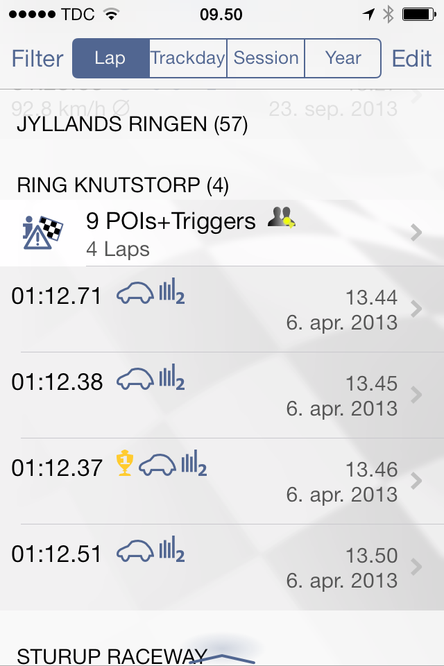

Hi Harry
Managed to get my 4 fastest laps imported again with intermediates. Very nice.
