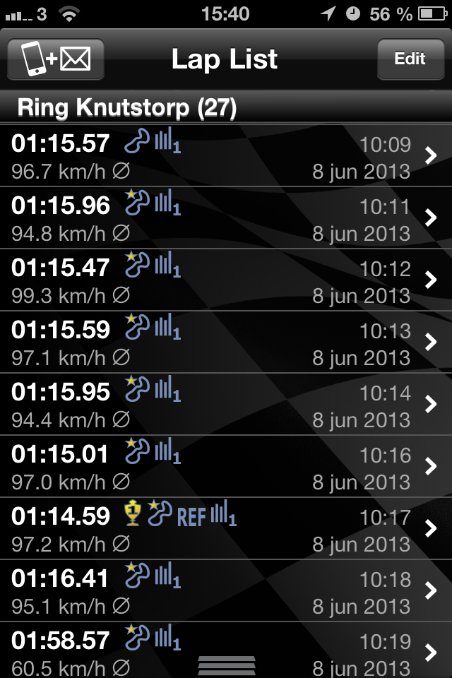

tried Harrys LapTimer for the first time today. It displayed the lap time each time I was crossing
the start/finish line. Just one problem I recognised afterwards, all laptimes in the log is approx. 3 seconds
slower than the time I was given during the race. Which is the correct time, the time I was given during race
or the times in the log? If it´s something wrong with the log, what can I do about it? :?
Thanks in advance!

The log i refer to is the one in HLT, picture below.

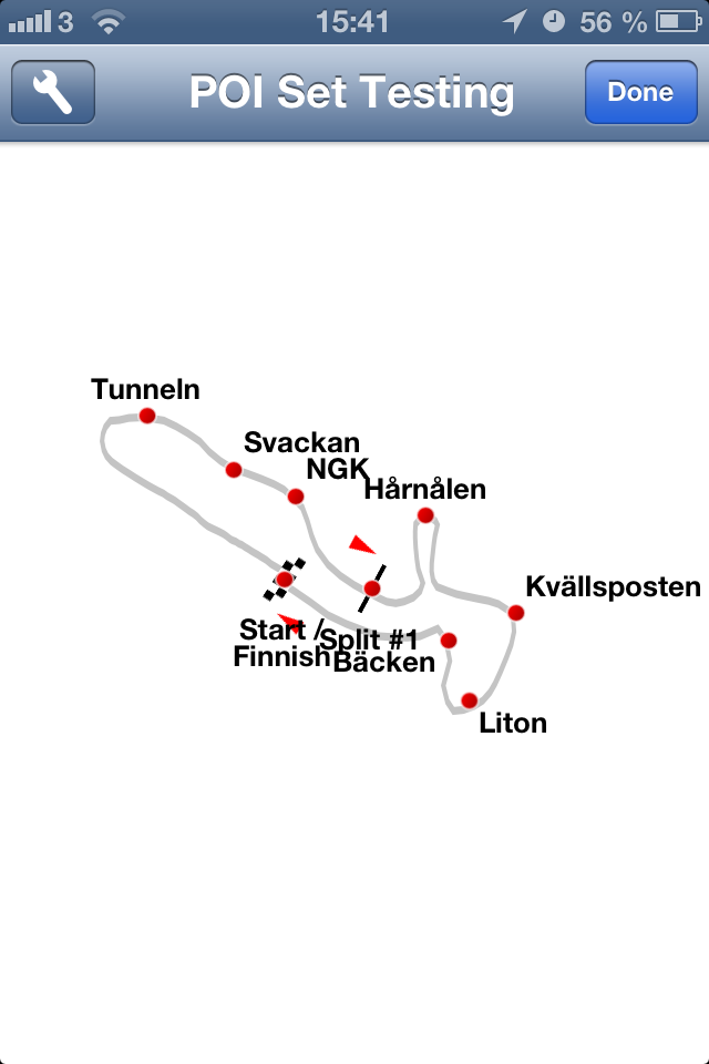

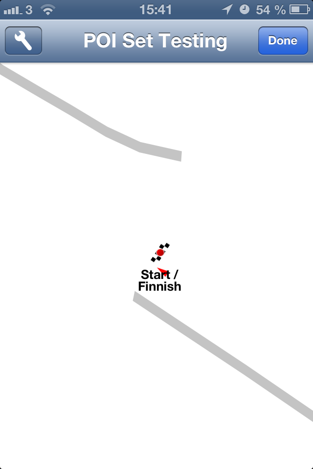

At a first look at the track in POI setting it looks ok, but a close up you could see that
there is a missing route at start/finish. Could this be a problem? The time was compared

Re: Displayed lap time vs. log
O.k., I understand. The times shown in the Lap List are the times that count. You should see exactly this times blinking once you have past the start / finish point. Anything before this blinking results are "running" values. Taking the driving direction into account, the last snapshot simply shows you were driving different lines in lap i and i+1. In case you zoom in more, the gap looks even bigger ;-) LapTimer always uses the perpendicular projection of the trigger to the line driven as the "real" position. So if you draw a line from the first point of the plot to the last one, you will see it crosses the trigger. So net net this is all fine and your times are those in the Lap List.
