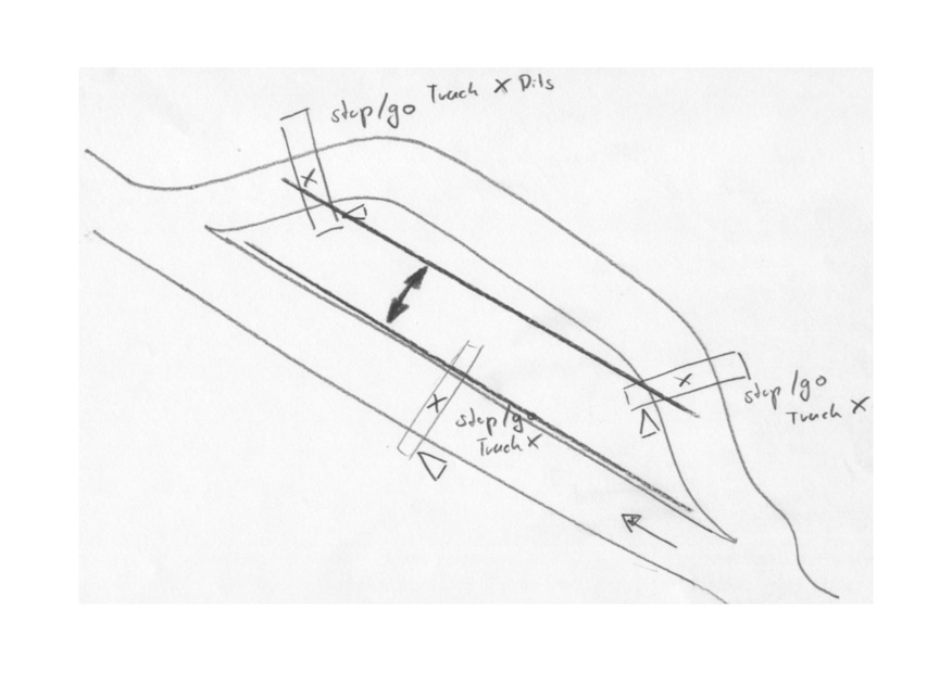

How far should trigger be away from each other, not to interfear with one another?
If I do, as You suggest - setting a stop/go-trigger at the entry and the exit of the pit lane, i could give them a direction, so that they won´t affect the trigers on the track. This of course works only, if the pit lane is accessed against the drivig direction on the track (on this special course it is like this)

Please have a look into this sketch:
The distance shown is the critical component. It needs to be bigger than any corridor LapTimer uses to detect triggers. As long as the stop/go trigger on the start / finish line has a direction, LapTimer will always use a wide corridor. This corridor's width is 25m by default. As LapTimer adds the current accuracy, we need to have a minimal distance of 35m (25m plus 10m for an o.k. accuracy) between the right end of the track and the triggers positioned in the pits. Actually it is irrelevant if the additional triggers are on the pit lane or if they are moved further to the right. They need to be at least that 35 meters away.
As an optimization, you can remove the direction from the stop/go triggers in the pit lane. In this case, LapTimer will use the normal corridor if set like this in Settings. The normal corridor is 15m by default, so the min overall distance needs to be more than 25m (15+10) in this configuration. To not get a new lap triggered when passing the pit lane, you need to remove direction from the track trigger too.
Hope that is not too complicated. In case you have a chance to test this, please let us know how it worked.
