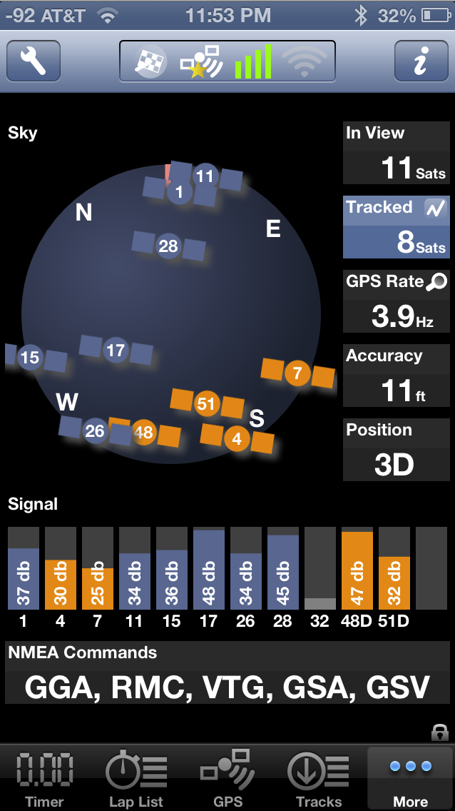

Will do Harry, I am looking forward to it. This is what I see every time:
Screen Shot 2013-03-20 at 11.57.35 PM.png (195.08 KiB) Viewed 8525 times

Harry, isn't that just going to make mine show 4Hz? How would making 3.9Hz less volatile and rounding up to the nearest Hz make it 5Hz?
Is the underlying problem that the Dual isn't sending 5Hz? Or is the underlying problem in iOS?
Edit: Checked the .csv export of some laps at my last event, and there are 4 events per second.

Well I tried so hard ;-) Precision display does not change anything, correct. But that is item b) from my note. Item a) is a different topic and I'd suggest you re-test once v17 is available. The raw data attached above are recorded at 4 Hz, you can see that easily by watching the time stamps (.25, .50, .75, .00, ...). At 5 Hz, you will see .00, .20, .40, .60, .80, ... Not sure the Dual switches from 4 to 5 Hz depending on the receiving condition.

Thanks Harry, I'm quite sure it's not the fault of HLT and rather something with Dual. I'll keep an eye on it, but I walked outside today in clear skies watching the rate (and the racetrack is out in the country) and I've never seen it go to 5hz. Was just wondering if there was some trick I was missing. :)

No, misunderstood, LapTimer just measures, I'm aware it is not the source for any issue (at least here :-D ). Did you get a differential lock (shown as "3D+" or "DGPS" in LapTimer)? When I testing mine yesterday with latest firmware and iOS version, and got 5 Hz, it had clearly no DGPS position (had the receiver in my office).

Harry wrote:No, misunderstood, LapTimer just measures, I'm aware it is not the source for any issue (at least here :-D ). Did you get a differential lock (shown as "3D+" or "DGPS" in LapTimer)? When I testing mine yesterday with latest firmware and iOS version, and got 5 Hz, it had clearly no DGPS position (had the receiver in my office).
Nope it only says 3D, not 3D+. Where would I see the DGPS?
