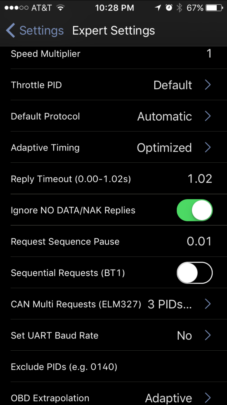

- IMG_1119.PNG (85.59 KiB) Viewed 11912 times
Re: Kiwi 3
3-4 Hz is what can be expected as long as you do not have parallel requests enabled. As the snapshot does not show "parallel requests enabled", please recheck Settings ‣ Expert Settings ‣ OBD Tweaks ‣ CAN Multi Requests is really set to 3 PIDs/adaptive.

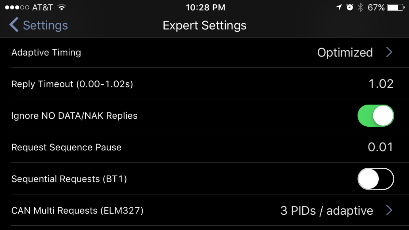

Yes, it is definitely 3 / adaptive. Screen shots attached.

- IMG_1128.PNG (187.42 KiB) Viewed 11894 times
- IMG_1127.PNG (145.3 KiB) Viewed 11894 times
