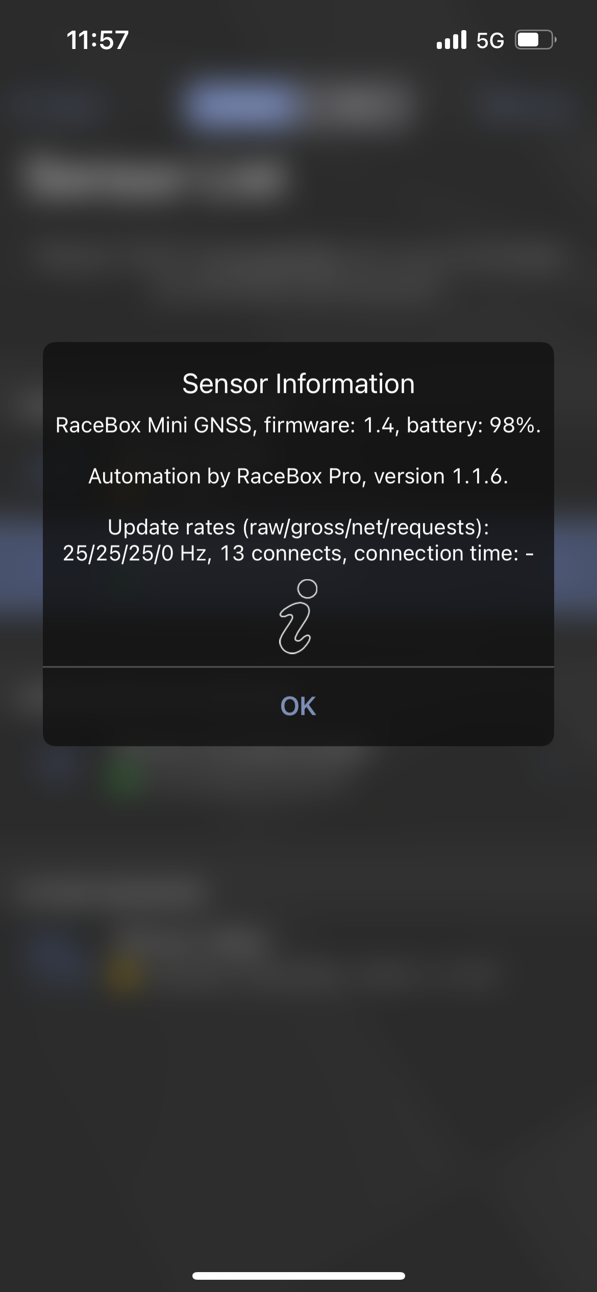

I don't know what happened with the last update for iphone but the Racebox Mini is now completely not working with Harry's Laptimer.
I ran two track sessions, the connection to Racebox Mini was showing in the sensor list but I did not get any lap time at all. I could not see any satellite information by clicking on the sensor. No bars for satellite reception in the timer screen displayed. The only information is the screenshot I attached below.

Bluetooth devices without pairing requirements (actually BT LE) are connected when discovered, automatically, and first come first serve. Once you are connected to e.g. a GPS device, other GPS devices are ignored. Furthermore, since the last LapTimer update, you can disable sensor types completely. If e.g. you get connected to a Veepeak, goto Sensor List and swipe / long press it to disabled it. You can do so front up.
We have no "lock to a specific device" currently. Actually this has not been required until Racebox Mini entered the market. It has an extremely long connection range. However, once are connected to your Racebox, others will not be able to connect.

Ok, this is an issue then.
I think the reason why the Racebox Mini is not working is because multiple users with Harry's Laptimer is connecting to it so it will not work with my iphone. Either that or the connection is just not working at all despite saying it is connected in Sensor List.
Racebox app can identify your own Racebox Mini device based on device number and choose to connect to it, can we have this functionality too?

I will do a real live test this Winter - without disturbing other sensors around. In case this works, I need to check how to further restrict connections to known devices. Actually I hoped to not need this…
