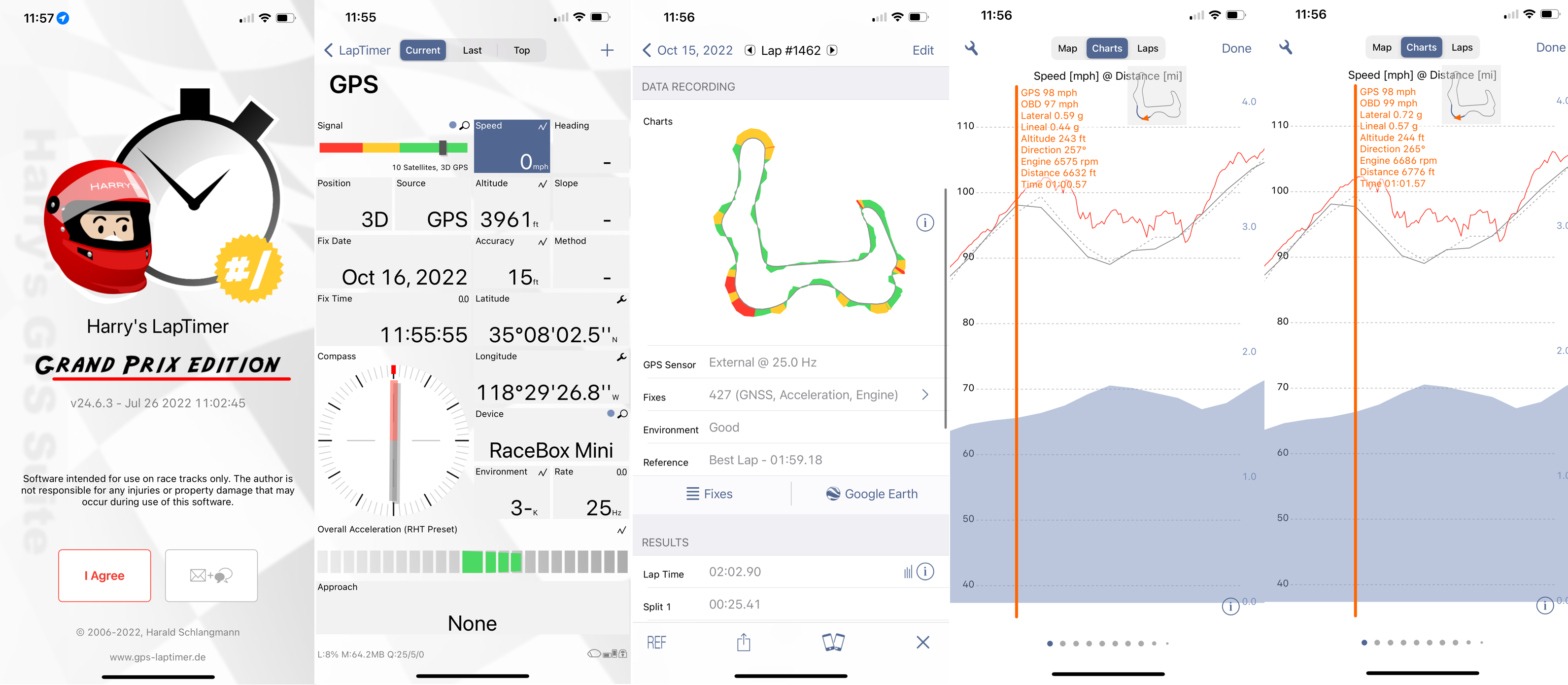

I recently accquired a Racebox Mini and have the same issue with v24.6.3 on iOS.
GPS and actual lap display it as 25Hz, but the actual speed trace is in 1Hz.
I hope this will get fixed in future version soon.

I did a few test drives with my RaceBox Mini (Petrolhead Edition V24.6.2 with in-app upgrade to Grand Prix Edition, Android) and it only stores GPS fixes at 1Hz. I went through the things suggested in this thread, the sensor is connected at 25Hz, but the in-app GPS fixes are at 1 Hz as well as all exports I tried (csv, kml). Let me know if you need some logs.

Good news! All 4 manual "laps" I just did show as external @ 25Hz.
Curiously instead of the 5hz worth of fixes I saw previously when it did work, I'm now getting 3.75-4Hz, but as its just me walking around outside I won't read into that. Need to take it out in a car with me.
