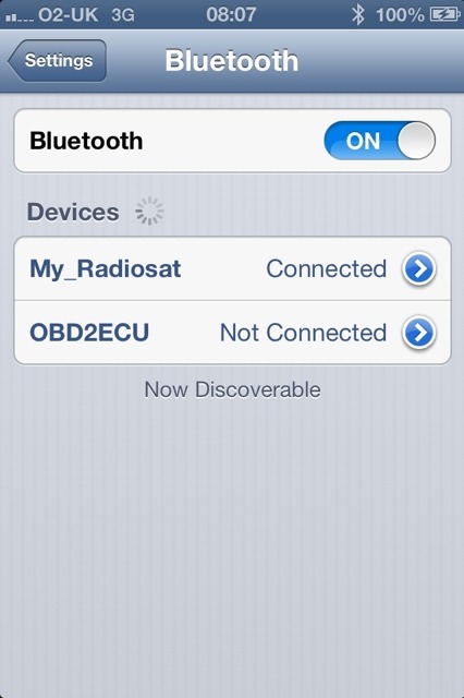

anyone else having issues with roqybt4 after 6.X? I'm now on 6.1 and my obd reader appears to connect but won't transmit/receive data?
Re: roqyBT4 and Bluetooth OBDs!
Posted: Wed Feb 06, 2013 11:18 am
by rscliofan
As you can see its shown at the bottom
But I also see apple is also seeing it which it's never done?
Perhaps it's interfering with it?
Posted: Wed Feb 06, 2013 11:51 am
I cannot comment on the Apple BT / roqyBT relation (check with the roqyBT people). The first screenshot means the OBD is detected but the request / reply dialog is not started successfully (so actually not communication).

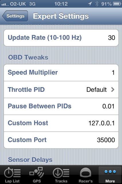

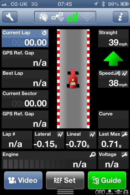

by mx1000
I just ordered RoqyBT4 and Harry's Lap Timer Trainer. ;)
I'm using an Ipad Mini, jailbreaked with an ELM 327 connector.
And I have exactly the same issue as described above :
->ELM 327 detected
->Roqy BT says OBD Server Started @ 127.0.0.1:35000
->Harry's Lap Timer shows the OBD sensor connected @ 0.0Hz
But there isn't any ODB data readable for HLT. :roll:
Rscliofan, what was your fix ?
Posted: Wed Mar 06, 2013 9:20 pm
by rscliofan
did you set the obd pass key to the correct setting in RogyBT4 configuration? (1234 usually). Also set automatic paring on data request to ON and in laptimer expert settings? More tab ->settings->expert settings-> in obd tweaks custom host needs setting to 127.0.0.1 and custom host 35000
