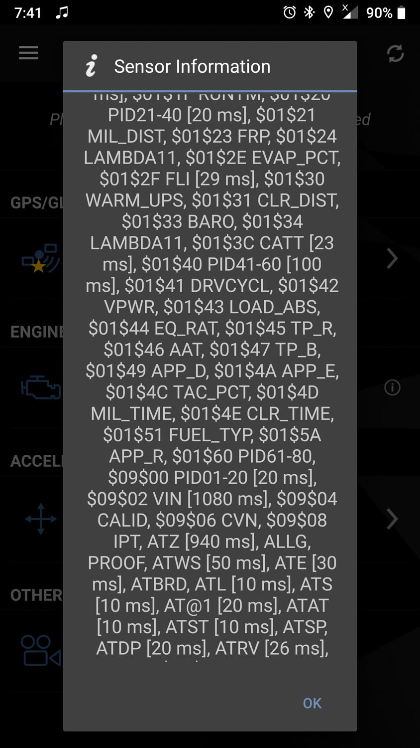

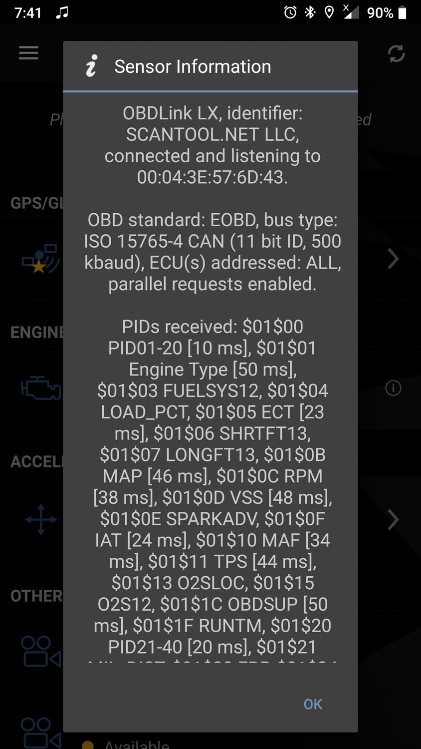

So I've been trying to get my oil temp to display on my 2016 GT86. I'm using HLTGP with an Obdlink LX. I've used the custom PID as mentioned in previous posts, only my oil temp display still reads as "-".
Here's some screenshot of the sensor info, I hope these are the details needed, any help would be most appreciated as oil temp was the main reason for wanting to log data in the first place.
Thanks a million!

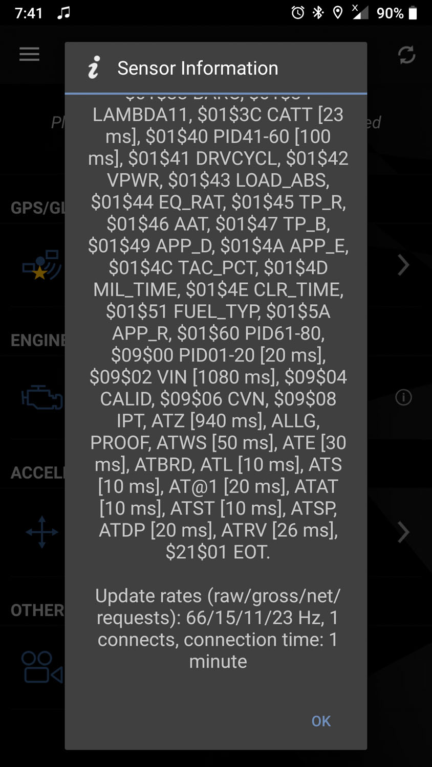

In the last snapshot, you can see $21$01 EOT without a reply time in brackets. This means the custom PID has not been requested. This may be due to a configuration problem with the custom PID, or simply because the sensor has not been restarted after entering the custom PID configuration. For the first, please post a snapshot of your custom PID expert settings, for the later, goto Administration ‣ Sensor List and select Refresh from the top right.

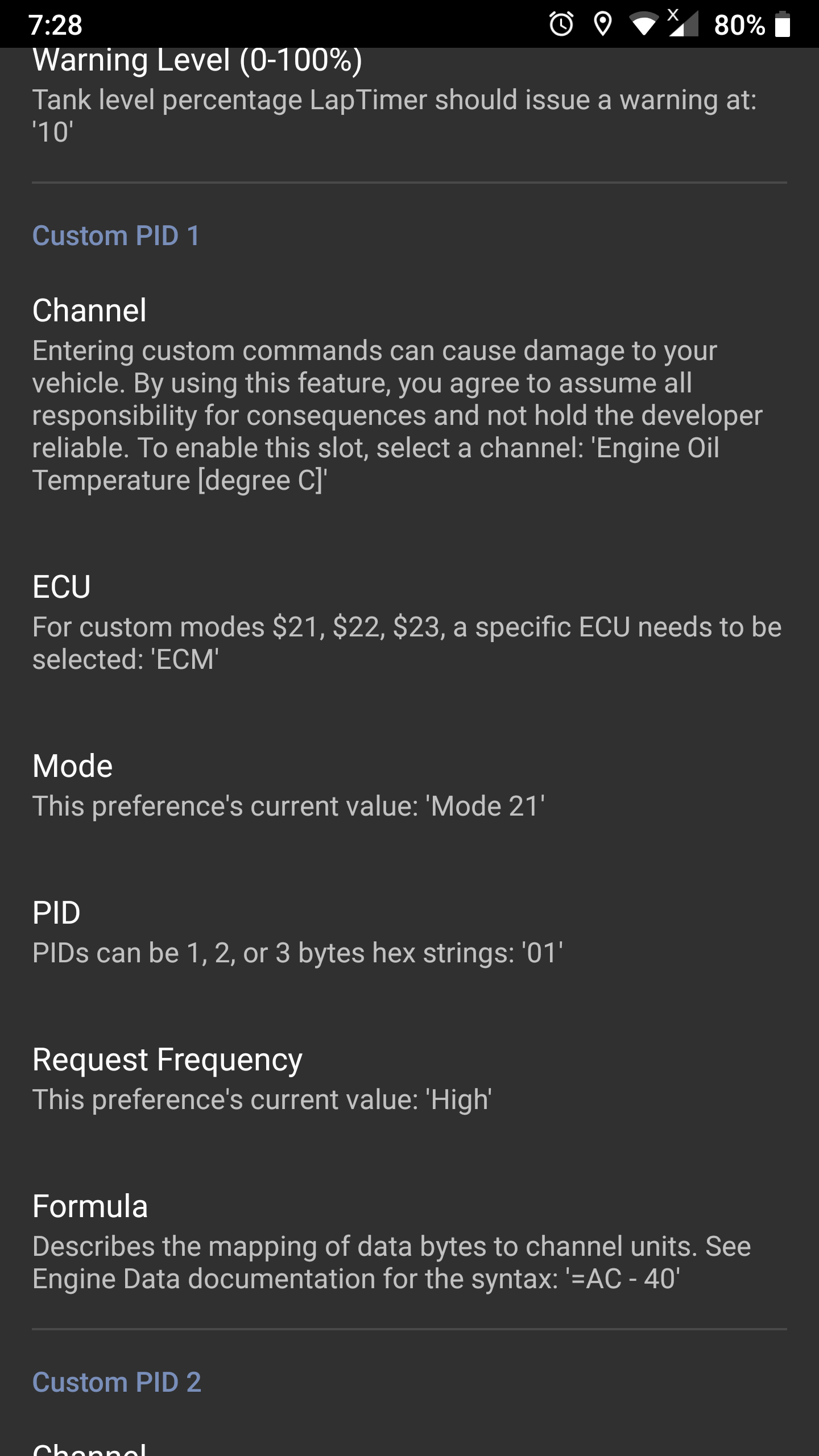

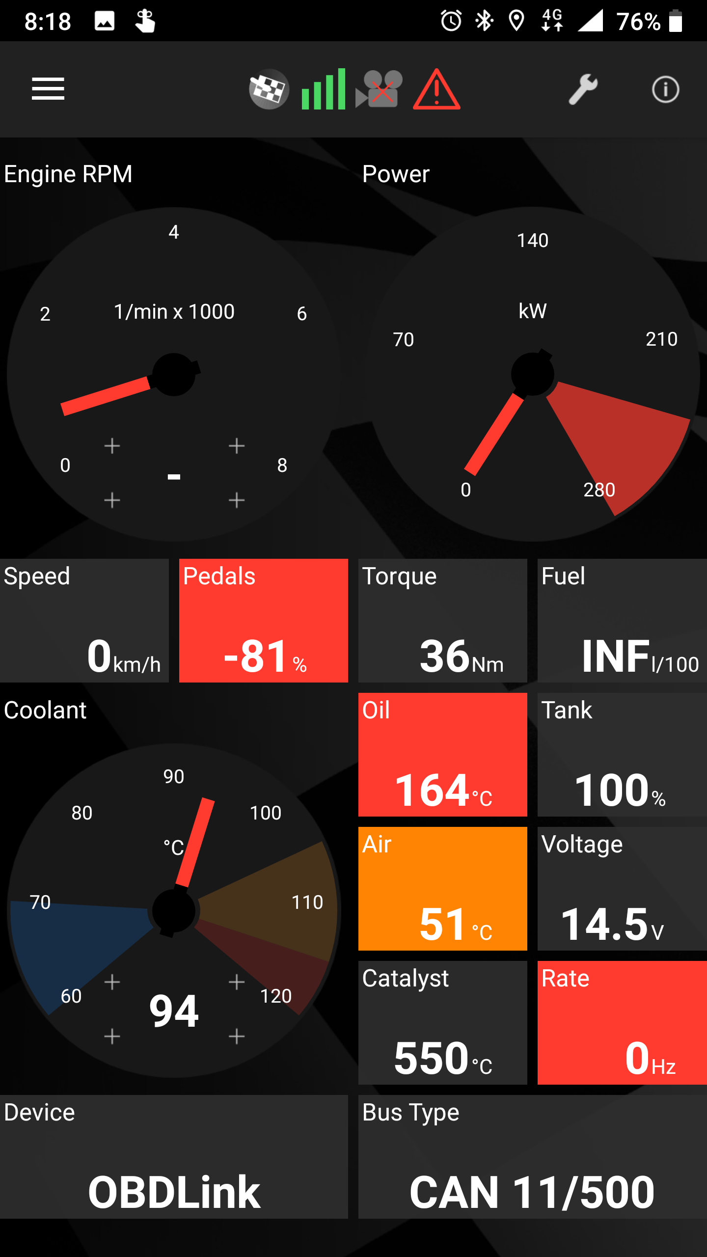

Thanks for the quick reply! No problem, screenshots below. I do get an oil temp display now - refreshing previously hadn't been working for some unknown reason, but I took the car to work today (moderate stop/start traffic for 20km) and managed to get the oil temp reading once I refreshed the sensor list again when I arrived. There was some stop start traffic, but the car is fitted with an oil cooler and I find it very very hard to believe that the oil was 164 degrees. I'm wondering if the -40 in the equation isn't registering correctly? 124 deg still seems high for this car fitted with a cooler, but I understand that the oil temps are calculated and not actual, so perhaps it's just that inaccurate?

164 is too high. To check what is going on, please do a manual recording: enable Manual Timing in LapTimer Settings. The next time you drive around, press the Start button in Timer View. Record the whole drive and stop the recording when you stop. Select the “lap” recorded from Lap List and have a look into Charts / Charts / Temperatures. In case you have a dashboard gauge for EOT, watch what it shows so we can understand the relation. In case your LapTimer edition doesn’t show temperatures, export the lap to HLPTRL and send it to me.
