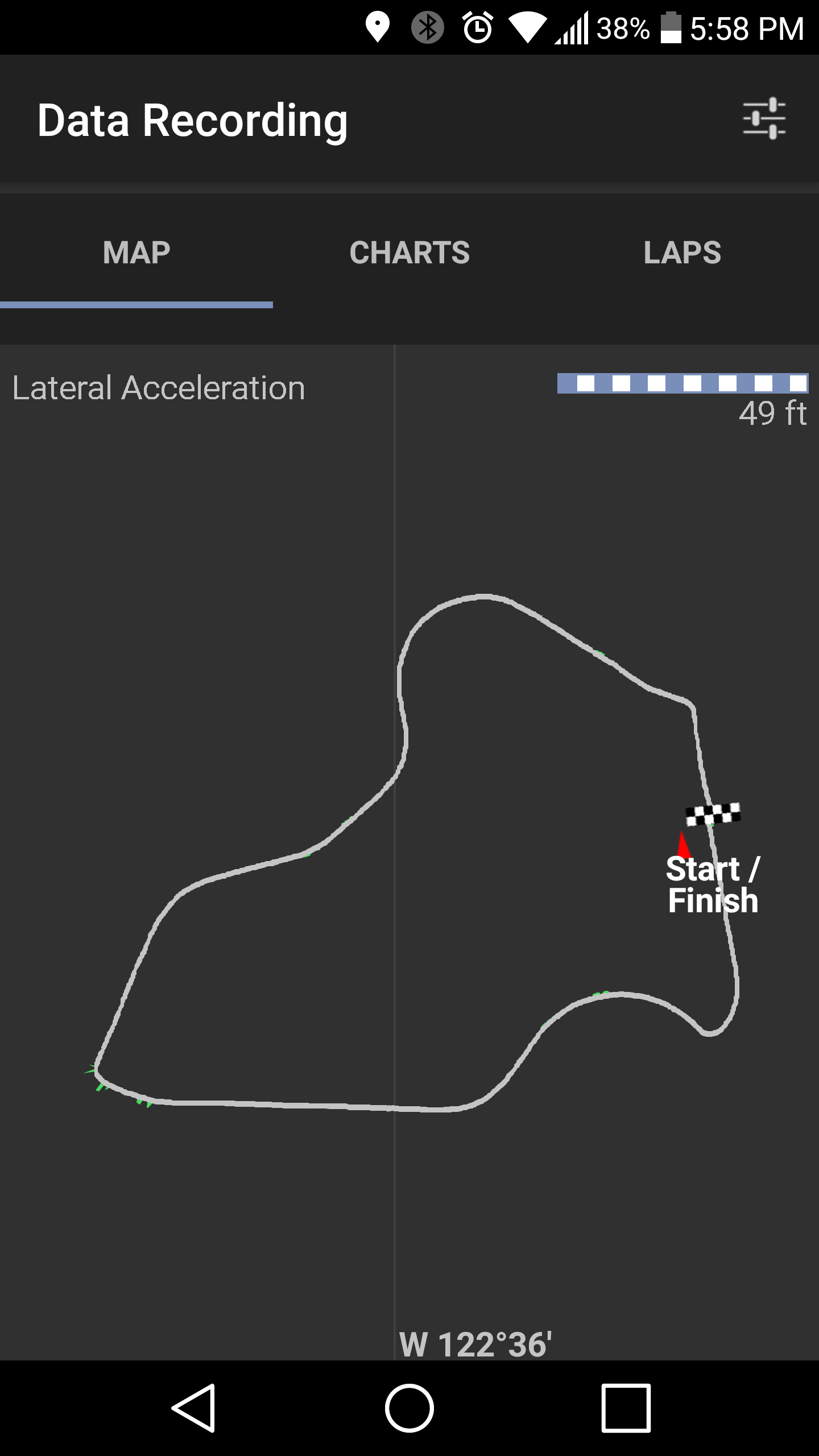

I just ran a test on a neighborhood loop. Drove one lap with external GPS - XGPS160 - and no acceleration data showed up for that lap, other than a few small spikes of lateral g.

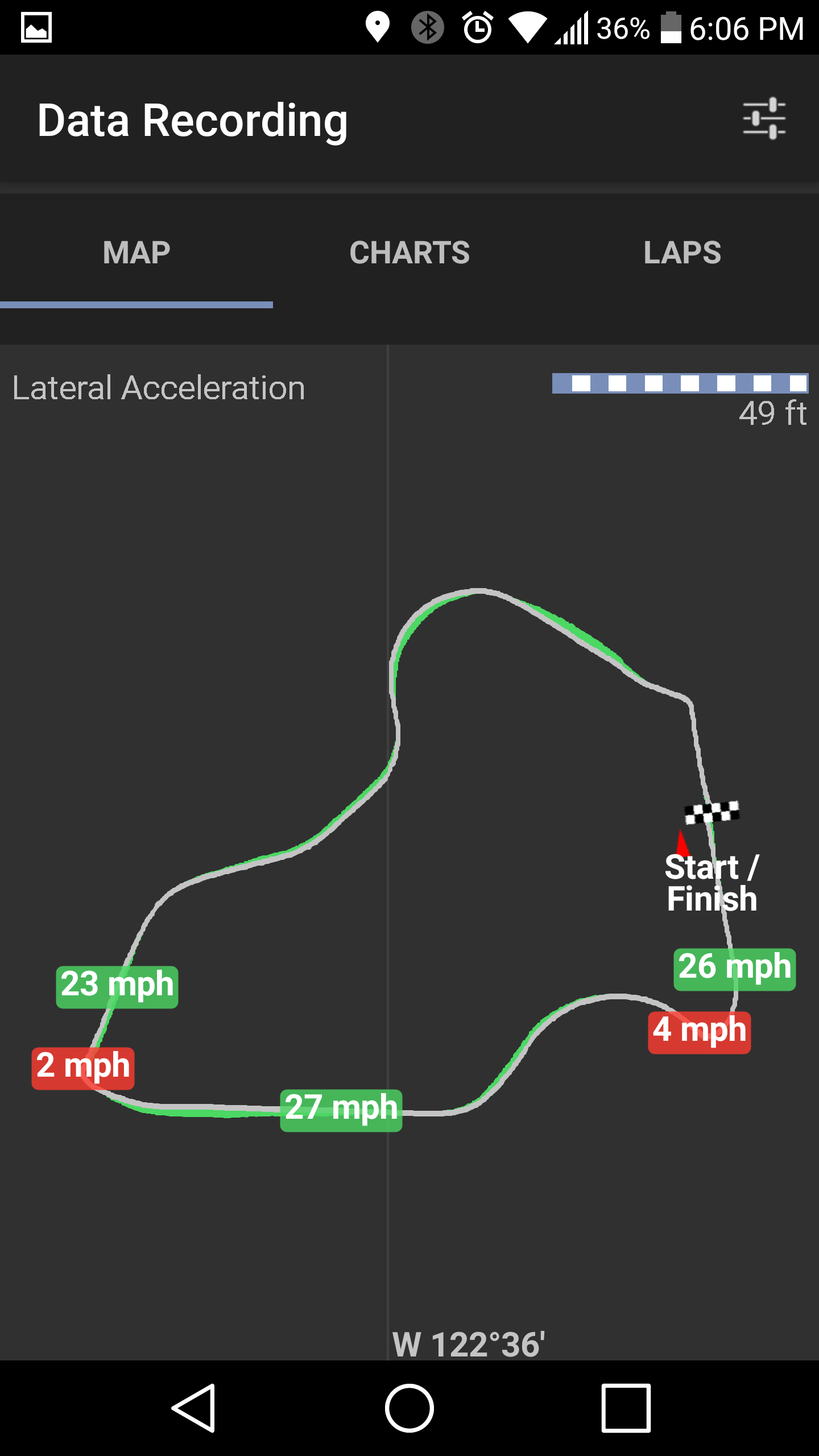

Then did another lap with internal GPS only - it recorded acceleration data just fine.

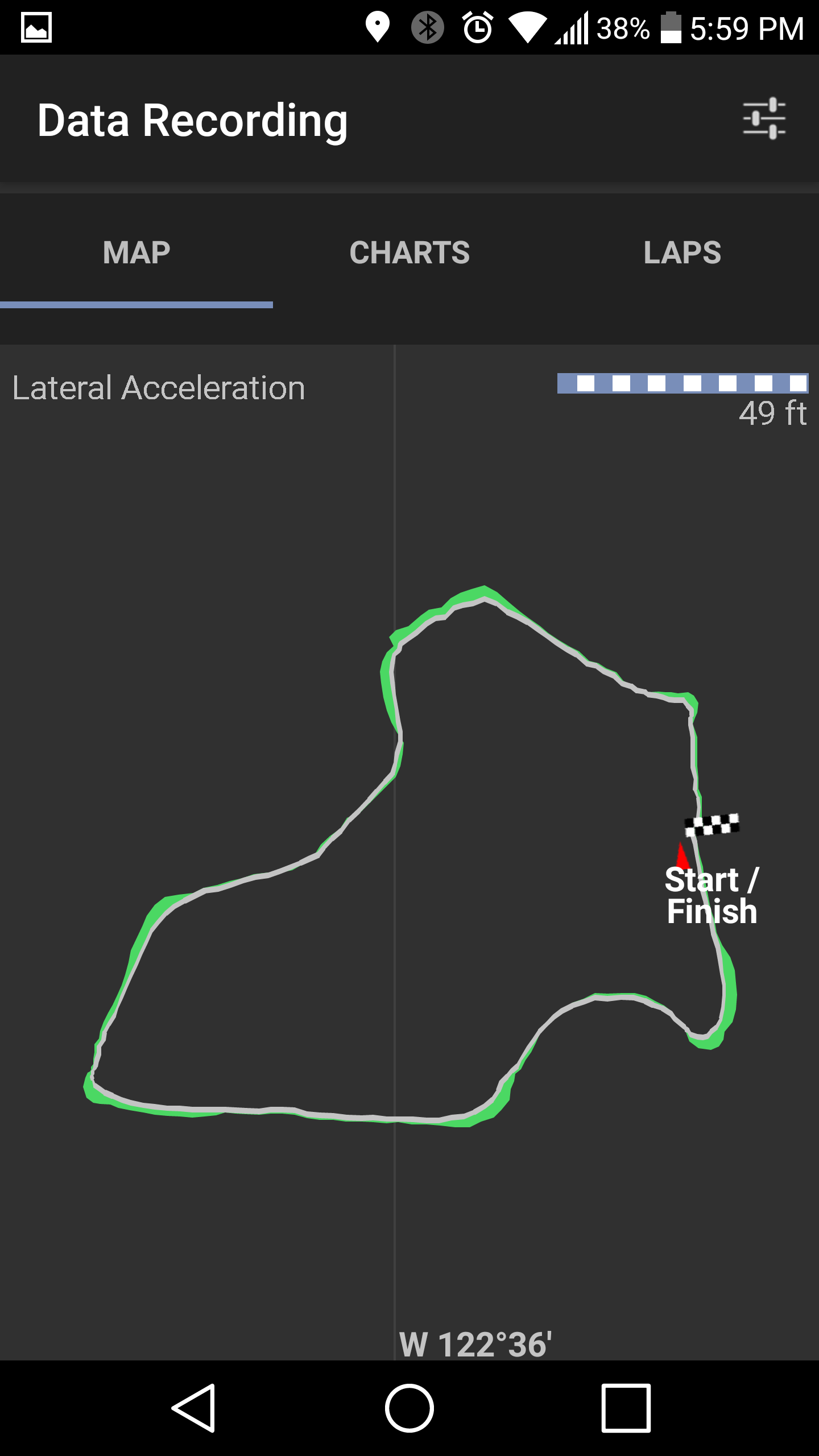

Yes, there is sort of a work around, but no where near accurate. To use workaround - Open up the lap without acceleration data, scroll down to Recalculate, press Acceleration. You will then need to slide the smoothing slider up almost all the way to Strong, to get the best results. Apparently this recalculation uses GPS data to approximate the acceleration data, but it is a very rough approximation. Seems to under records lateral G by 15 - 20%.
Keep in mind, this was driving around my neighborhood at 20-25 mph...
Here is a screen shot of the first lap with External GPS:
Screen shot of 2nd lap with internal GPS - normal...
And here is a screen shot of the 1st lap - after recalculating the acceleration -
