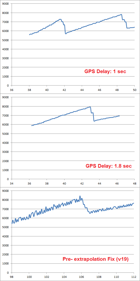

I'm happy to report that my OBD data is much smoother than it was before. Here is a comparison at full throttle going through a gear.
The first two are with v20.0.17 (w/ fix) and I adjusted the OBD delay to 1.8 sec (recommended in this topic). Didn't seem to make any smoother but maybe it will match my video better. I also included RPM data from a previous track day (pre-fix) and as you can tell there is an obvious difference.
This seems to solve one of my biggest frustrations with the data I was getting. Thanks Harry!

Thanks for the feedback. Please reset the sensor delay to default again. This made LapTimer not extrapolate OBD data because it shifted data out of the valid time for extrapolation - but certainly misaligned OBD and GPS data in general. So it had a pro and cons.
