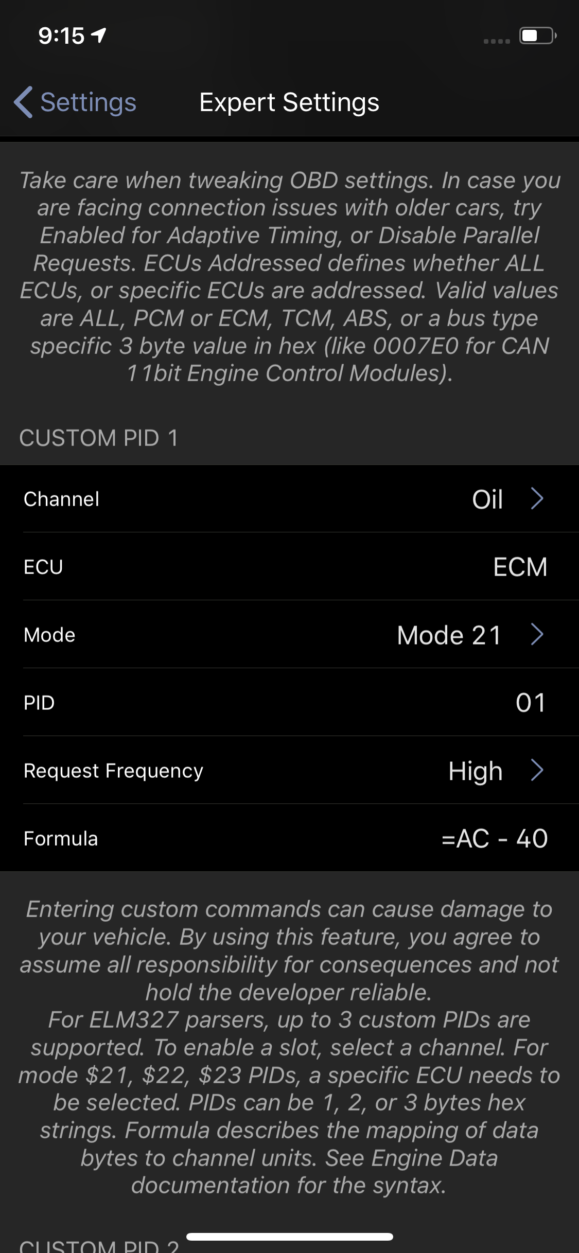

Here's the general steps:
1. Go to Settings, then open Expert Settings
2. Find the Custom PID 1 section
3. Set the values as per below. Note spaces in Formula
Expert Settings
Expert Settings

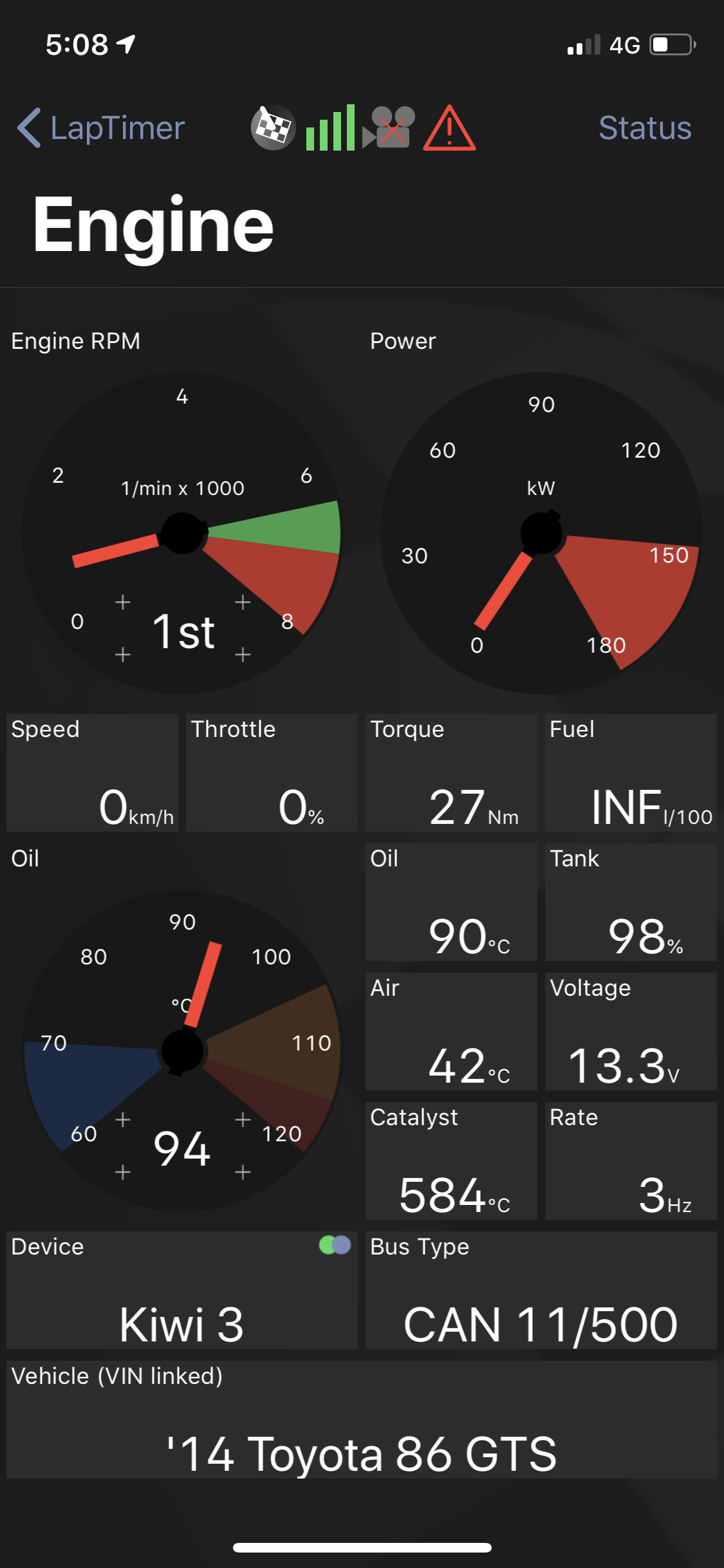

Here's what the oil temp readout looks like:
Oil readout (94 celsius)

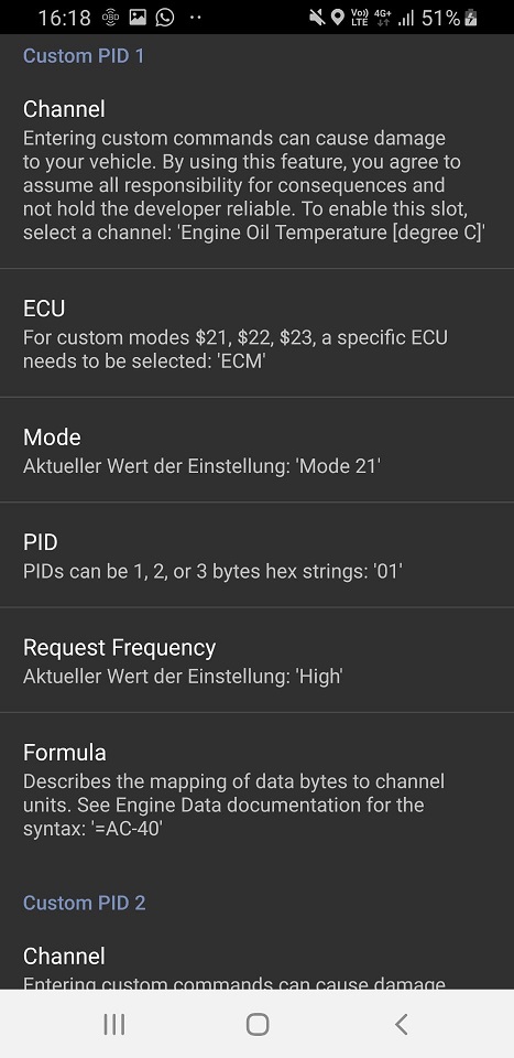

Posted: Mon Jun 10, 2019 9:09 pm
Are you sure you have selected the correct (EOT) channel in Custom PID Settings? Share your settings as a screen shot please in case you want us to check. Please add a screenshot showing both coolant and oil values too.
Coolant and oil temperatures should certainly not be the same.

This is my setting:

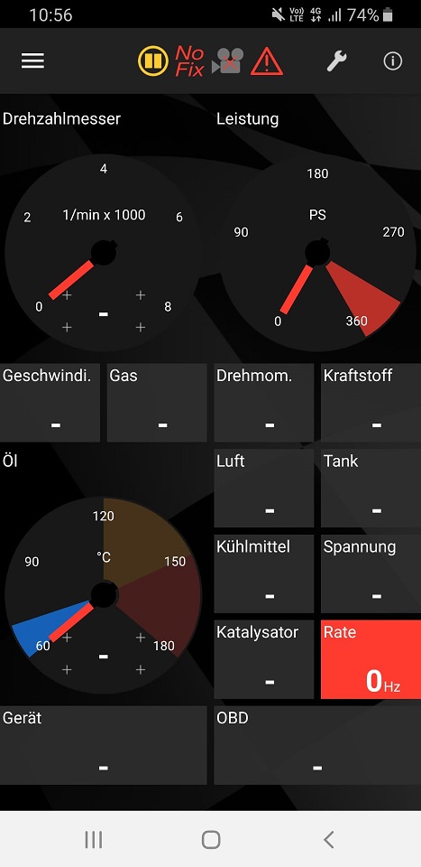

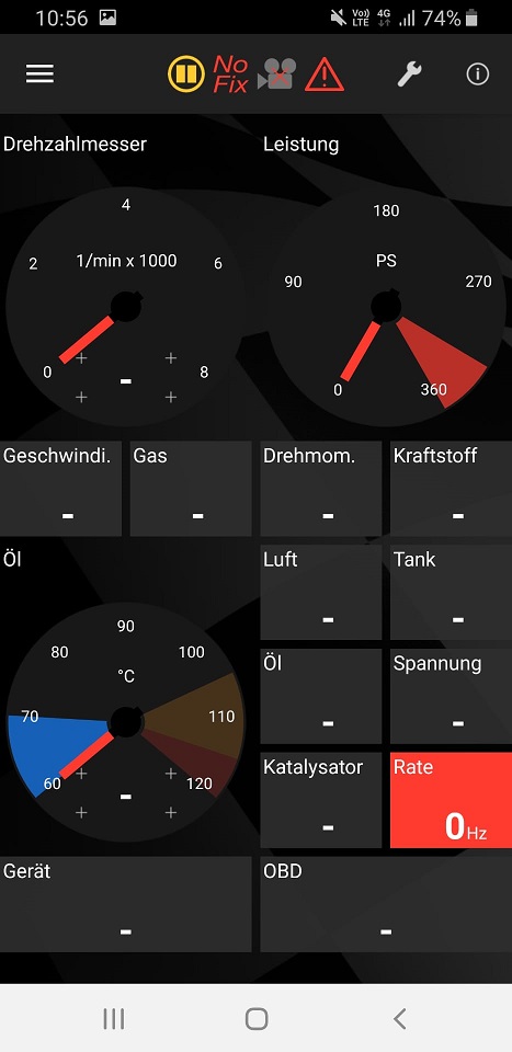

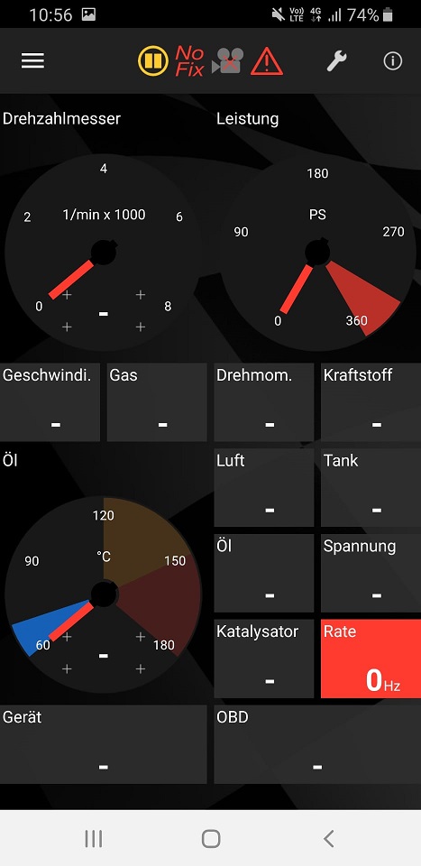

And when I open the dashboard for the engine I see (currently not connected as I am in office):
Then I click on "Kühlmittel" and the view changes to:
And I click again on "Öl" then changes the view to (notice how the scale changes):
So I was wondering if I somehow now have 2 values for Oil temperature available whereas one is equal to the "Kühlmittel" and the other not.
Also I was wondering how I can see the "Kühlmittel" and the "Öl" value at once in the gui.
Posted: Tue Jun 11, 2019 9:11 pm
When touching any small temperature field, it will get the one shown in the gauge, and the gauge temperature will get the one shown in the small field. That’s how it should be. At least with no OBD sensor connected, this doesn’t work currently. I will check for the next bug fix release.
