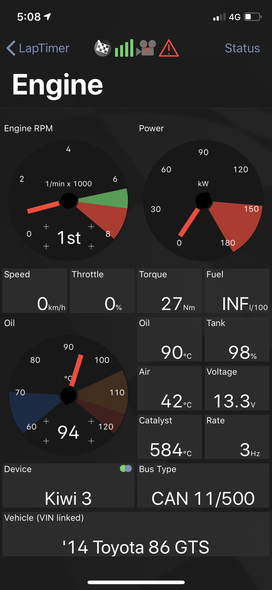

Here's what the oil temp readout looks like:
Oil readout (94 celsius)

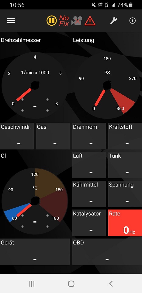

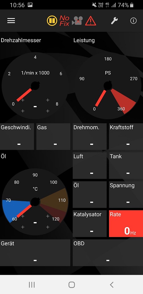

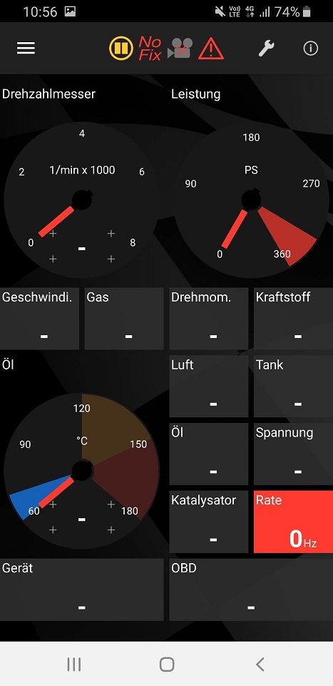

And when I open the dashboard for the engine I see (currently not connected as I am in office):
Then I click on "Kühlmittel" and the view changes to:
And I click again on "Öl" then changes the view to (notice how the scale changes):
So I was wondering if I somehow now have 2 values for Oil temperature available whereas one is equal to the "Kühlmittel" and the other not.
Also I was wondering how I can see the "Kühlmittel" and the "Öl" value at once in the gui.
When touching any small temperature field, it will get the one shown in the gauge, and the gauge temperature will get the one shown in the small field. That’s how it should be. At least with no OBD sensor connected, this doesn’t work currently. I will check for the next bug fix release.
