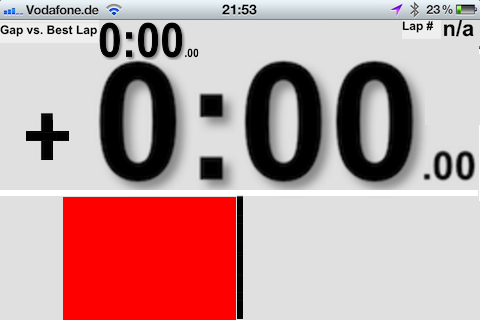

yes, the portrait layout has almost all the requested features. It is lacking the slider for delta which could replace the acceleration slider. The slider is a quick way to see the delta instead of reading the numbers, and the instantaneous speed comparison (red box) is too small to see quickly. You have almost all the information I would need there but it is too hard to be useful at speed while I am worried about the other wheel to wheel racing. You have done a great job with the technical functionality. I am just suggesting a way to easier visualize the important data while racing. I have attached a Mockup of one way to display the pertinent info, making the delta time and slider the largest they can be, with a small reference to your fastest lap and what lap you are on. (I think you could also include last lap in the same size as fastest lap, and also Flash last lap time on delta area in large font as you cross start finish for ~3sec. iRacing changes the color of the lap time text if it is your fastest lap. So if you set a new fast lap, maybe green instead of black (iracing uses purple...)Harry wrote:I understand this is a different layout, but isn't your requirement not nearly exactly covered by the portrait Timer view in LapTimer (viewtopic.php?f=10&t=513#p2661)?
The settings buttons and options buttons are not needed while racing since we are wearing gloves, so once you start your lap there is no way (or need) to touch the device. Upon start of the first lap or delay of 1min from starting the timer, you could minimize the menu bars to give more screen area to pertinent data, and after race, upon touch of screen bring back the menus.
I would pay extra for this High-Visibility minimal data option. Our phone is mounted to the side of the center console, past the other gauges that we use, so bigger numbers and info are very helpful.
Thanks for your consideration!
-Chris

Hey bulls,bulls23 wrote:Since your main point is the bar. is 't the Racer's view more what you are looking for? The biggest info there is the red race car in comparison to the reference lap, either being slower or faster.
In the racer view with the car, you only have delta between you and reference lap, only the slider, but no instantaneous speed difference. Check out the video to see how the slider I am thinking of works. You get both references by changing the color of the slider bar to represent the speed difference, and the location of the slider bar to represent your difference in time.
http://www.youtube.com/watch?v=sAZcwfXe ... page#t=308 The slider description starts at 5:08
This is useful for me to have both measurements, because for example, you enter a corner faster than your last lap, your slider goes to the right, showing you are ahead of your fast lap, and green because you entered faster but because of your faster entry, maybe your exit speed is slower. So as you are exiting the corner , the bar is still to the right, showing that you are still ahead of your fast time, but the color changes over to red, showing you are slower, then as you continue down the straight, the red slider transitions from the right side(- faster time) to the left side of the slider, showing you are slower than your fast lap at the end of the straight due to your poor corner entry. The slider and the instant color work together to give you the whole picture. Next lap you know to slow your entry to get a better run on the exit and a better time on the straight for a faster lap.
They especially are helpful together when you do that same entry but going into the corner your time is either 1 or 2 seconds faster or slower than your fast lap, so instead of starting in the middle with the slider, the slider is starting on the right or left, but you still have the change in slider position plus the color of your speed difference to let you know how you are doing on that corner.
Also with the racers view, still too small for me to see easily out of the corner of my eye, at speed, in traffic. A large slider would be much easier to see then looking at the cars. (for me) If I had to choose between the instantaneous speed difference or the racer view with the slider I would choose the portrait view with the instantaneous speed difference, and look at the lap delta to get what I would get out of the slider, but it is too small currently to be easy to see.
I appreciate your recommendation though. I haven't used racers view a lot so I will give it another look to make sure I am not missing anything.
-Chris
