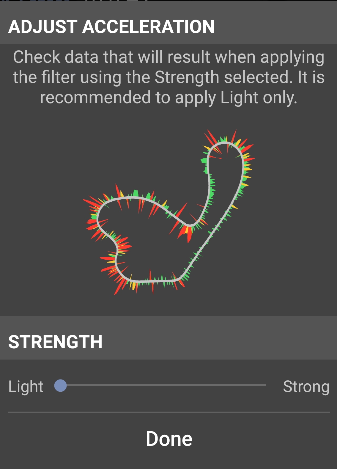

I have the same issue but it looks like there is acceleration recorded, just very erratic. Harry, I did your instructions to recalculate and I see the following - see attached.
Prior to doing the recalculation there is maybe 3-5 recordings only.
Re: HLT doesn't record acceleration data when using external GPS
You need to smooth the data. Currently, noise of positions is the dominant source of acceleration. Shift the slider to the right. Light means no smoothing.

Only applying "strong" smoothing eliminates the spikes. However I think something is wrong because it is showing no more than 0.75g on any corner. I am fairly experienced driver on R-compound tires that can hit 1.5g pretty consistently in other times.
