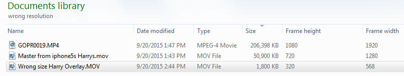

Re: Beginner's questions
I double check the sized and Standard master input for overlay was 720x1080. Listed sizes in windows and attached. I think this was Post iSO 9 update.Harry wrote:1. The output video size is exactly the size of the master video feed in. In case you get something different than expected, please make sure the master video is really coming at the resolution expected. Please use standard sizes (720 and 1080 height) only.
I have not tried your latest app version installed yesterday.
R
- shows input and output video frame w and h.
- wrong output res.jpg (25.43 KiB) Viewed 4290 times
I found the same issue with the latest version but I also found the the lower resolution happens when MultiCamPreset is set to none.rjmalm wrote:I double check the sized and Standard master input for overlay was 720x1080. Listed sizes in windows and attached. I think this was Post iSO 9 update.Harry wrote:1. The output video size is exactly the size of the master video feed in. In case you get something different than expected, please make sure the master video is really coming at the resolution expected. Please use standard sizes (720 and 1080 height) only.
R
If I change this to Single Density (Pic in Pic) then I get 720x1280 like your specificied in your answer.
