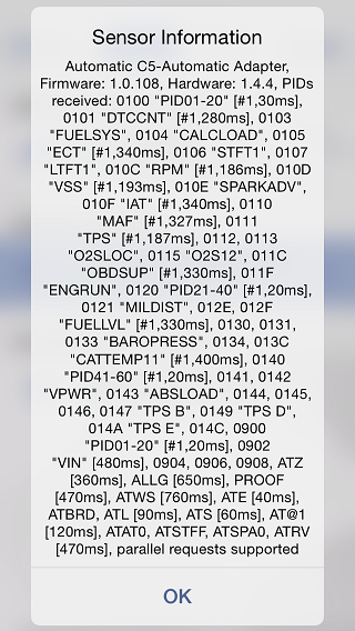

no luck for me. I tried the CAN and Non-CANBUS settings above and I'm always getting the yellow mode. I tried multiple others combinaisons of those 2 settings without success. Everytime I was closing Laptimer and reoppened it
When starting LT I'm having sometime the automatic account page asking for autorization, sometime it goes through, sometime a page asking to open that page in Laptimer (see picture).. Non consistant behavior. I configured safari to accept all cookies as recommended on automatic web site
I installed GPs buddy ad this one show the ODB as green and provided status. The GPs screen also show some info like RPM. GPS buddy only asked once the Autorization on automatic accound web page and never did after.
Anything else to try?
Re: Automatic Gen II, HLT (GP Edition)
The repeated authorization screens are actually an indicator there is an issue with this item. In case authorization doesn't work LapTimer will not receive data afterwards. Please contact Automatic in this, I'm sure they can answer the question if your adapter is authorized for the LapTimer app. The Buddy and LapTimer implementations are actually the same except they have separate registrations. The upcoming update (in review by Apple) changes the issue with non CAN cars only, no other changes here.

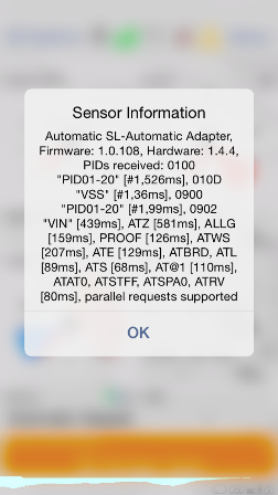

Everything is working with the specified non CAN bus settings (MY08 911 ISO-9141). I m also excluding PID 010F. However, I am still seeing some delay/pausing with the speed under hard acceleration.
Any other exclusions or other setting I can apply to help this?
should I have my car Bluetooth disabled while on track? I forgot to do that, but am not sure if it will make a difference.
Thanks.
The Automatic delivers cached data, so the update rate of 9Hz is the rate of exchange, not the real update rate. For non CAN busses, this will be around 2 Hz (which means approximately 8 to 10 values read per second). You can verify this by checking OBD speed in Data Recordings (available from Lap List - any lap). Select Charts and see GPS and OBD speeds side by side. In case you see the OBD speed is "stepped" / shows stairs, you know the reason for the delays in your. 2 Hz is simply to slow to show fast changing speeds. There is not a lot you can do about it. You may go for GPS speed in overlays (see speed selection in Overlay configuration) - at least if you have a 10 Hz mouse added.

I am trying to get the Automatic Gen 2 OBD to work with my 2006 Viper. I understand my Viper is a non CAN vehicle, so I made the proper adjustments in the expert settings.
I can get a proper refresh rate (~ 9Hz), but the only signal I get is voltage. There is no RPM, throttle, temps, etc.
What am I doing wrong? How can I fix it?
