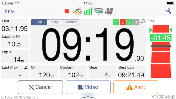

O.k., some snapshots to make a nice weekend :-) These are no Paintshop mockups but real snapshots already. The values shown make hardly any sense, so please ignore that part. "Laps to Pit" is implemented already and will hopefully generate reasonable results - even for faulty OBD fuel level reports.
But it is still a lot of work to do until I can release it. I need to complete this view, add support for 3.5' screens, need to add portrait, need to add iPad support and need to add Android support. Furthermore, I doubt this is the last iteration. ;-)
New features compared to the first draft:
  1. The gap is shown vertically to make a more natural orientation for "ahead" and "behind"
  2. Added a view for drivers focussing on a sector level
  3. Added sector indicators as proposed
  4. Added a Zoom option (see last snapshot) by touching the (big) time gadget; this is for those who want even larger digits
Thanks for any feedback.

One more screenshot to better understand the logic of "time won / lost" vs. "winning / losing time":
iOS Simulator Screen shot 22.08.2014 17.03.16.png (83.57 KiB) Viewed 6538 times
How to read this: the "street" shown to the right is shown red when losing time (compared to reference) currently and green when winning. The gap time (-01.45) is negative, which means time won (so far). So the above snapshot is saying: so far, you have won 01:45 seconds compared to the reference lap (green), but you are currently losing (so the 01:45 will go down). I have chosen to use the full street for coloring as the indicator "winning / losing currently" is the most important information while driving.

Harry wrote:One more screenshot to better understand the logic of "time won / lost" vs. "winning / losing time":
Great view, loved it! The big red or green bar indicating the status is indeed the most important thing.
I would add only the current lap number somewhere in the zoomed view, so in a race I don't have to find the lap counter at the side of the track (high speeds, usually battling for position, tucked behind the windshield, surrounded of other motorcycles, it's quite easy to miss it...). Is this viable? Thanks!

It's pretty and probably useful for lapping on a road course. In an autocross, at least for me, I don't even know the device is there, much less what's being displayed on it. My concentration is completely focused on where I'm going. A significant fraction of the time, I'm looking out a side window to find my next key cone.

Absolutely. The design principle (for circuit use) is to display large digits and color fields for data you may want to see while driving (Time and Gap), while all others are to watch while "pausing" on a long start / finish line only (Last, Lap#, Laps to Pit, sector results). There is another set of fields you will not really look at while driving, but which will get colored once something is wrong (temperatures).
