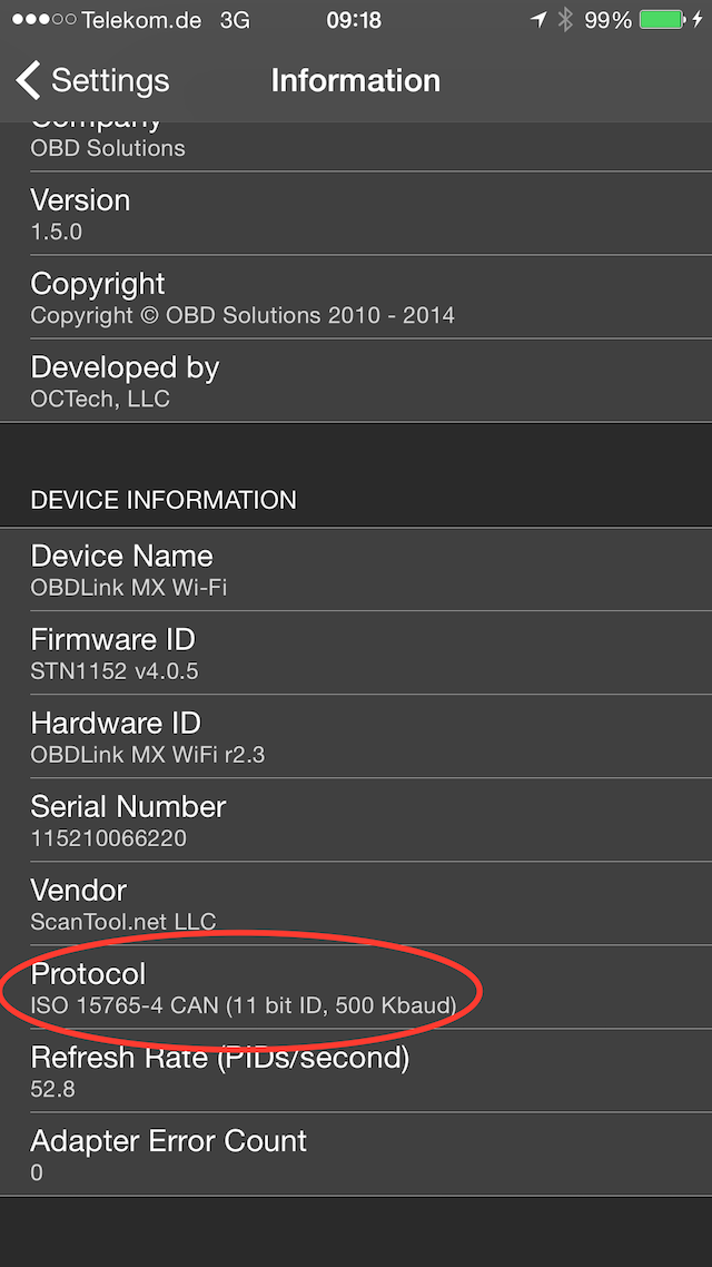

Please forget about the Dual for now, it is not related to the OBD issue. The protocols discussed are car bus protocols - again, this is not related to GPS / the Dual device.
To read out your car's protocol using the OBDLink tool, connect the dongle to your car and run it. Connect your smartphone to the OBDLink and start the OBDLink app. Press "Connect" and wait until the device is connected. Now, press "Settings", "Information", and scroll to the bottom of the screen. Now, you can see the actual protocol used:
- IMG_5281.PNG (179.22 KiB) Viewed 30664 times
Write down the protocol name. Kill the OBDLink app (to make sure we do not get conflicts with LapTimer). Start LapTimer and select the Default Protocol you have written down above from LapTimer / Settings / Expert Settings / OBD Tweaks. Send LapTimer to background, wait some seconds, and pull it forward again. Check what happens.

Harry wrote:Please forget about the Dual for now, it is not related to the OBD issue. The protocols discussed are car bus protocols - again, this is not related to GPS / the Dual device.
