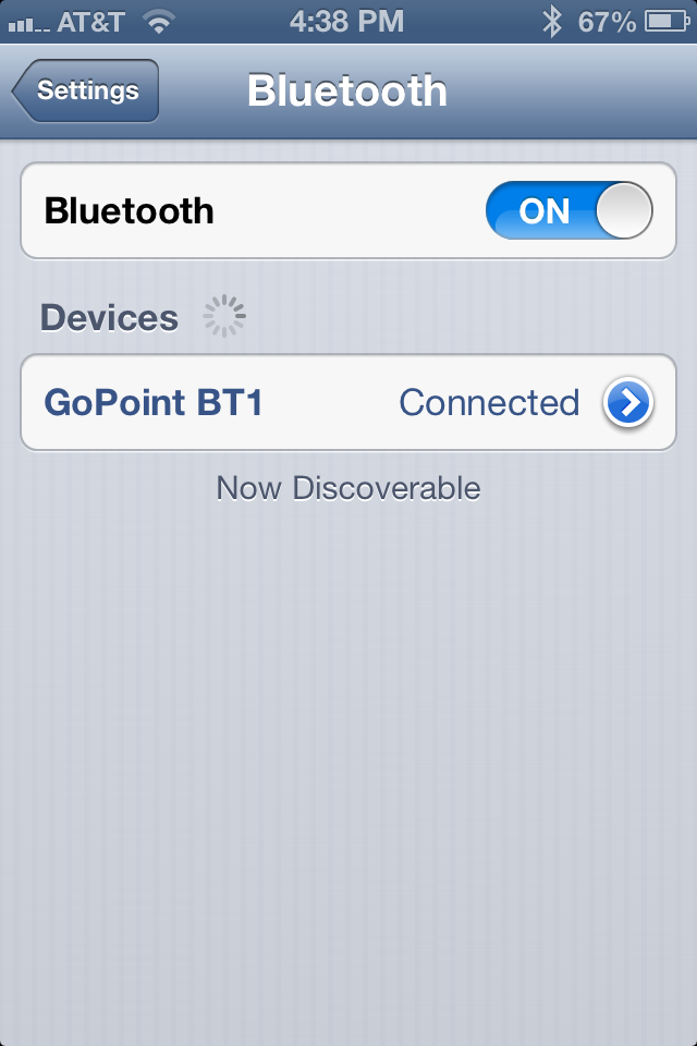

I have a few screen shots to show you. I eventually got the BT1 to pair to my Iphone 4. It works with my Mercedes S430 as it should.
It still won't work with my 2004 BMW M3 with a stock S54 engine. Here are the screen shots. If you have any final recommendations or ideas I would welcome them. I did send off several inquiries to the Hamilton folks for troubleshooting. However, they won't even answer me now.
Re: BMW vrs GoPoint BT1
Posted: Thu Jul 25, 2013 7:20 am
Please give us some more days, I work with several other BMW drivers to find a solution for this. It is pretty difficult as I do not have a BMW car around for testing. So it is always a long ping pong to generate logs / adjust the code and test again.

This just came into my email box this morning from them:
Connectivity to the BMW M3 has been frustrating for some time. Our thanks to Ray, with his help we have found a fixed an elusive timing issue with the ISO 9141 communication. The latest release of firmware for the BT1, BT1A and GL1 has these changes incorporated. The BT1 App will re-flash your hardware with the new firmware just released.
Best regards,
Tod Hamilton
GoPoint Technology Support Team
Posted: Thu Jul 25, 2013 6:13 pm
Yes, please check if this is related to your issue. As I have several (different) issues with BMW OBD replies this will fix some, but probably not all issues. Looking forward to your report!
Posted: Tue Jul 30, 2013 10:36 pm
by mousemaster
I think the problem is now solved. Many thanks to you Harry and the BT1 team. Success for the S54.
