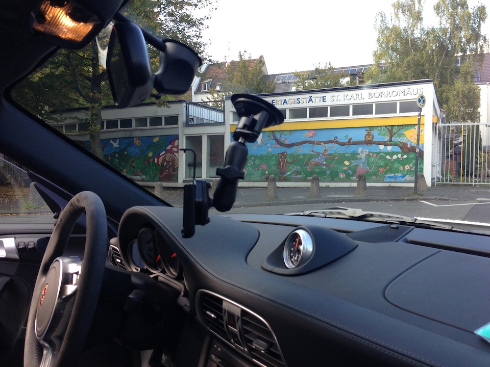

Posts: 10651
Re: Ram Mount Stability
This is how my RAM mount is installed. Pretty much top down instead of horizontally. You may test something similar.

Many thanks for that. I'll do some testing as you suggest, that makes perfect sense. Looks like I'll need a shorter arm as well.
