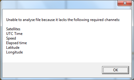

I just installed a newer version of Circuit Tools (v2.0.0.947), unfortunatly this version does not work well with HLT. I think some information is lacking from the VBO export. Does someone have the same experience or am I doing something wrong?
Maybe someone can share the old installation file of a previous version of Circuit Tools
Edit:
I now added the *.cir file of the circuits and loaded the right circuit in first place. Then try to load the VBO file from HLT but get the following error. The VBO seems to lack UTC Time format? The other channels seem to be in the file. Is this a HLT problem or Circuit Tools?
Edit:
