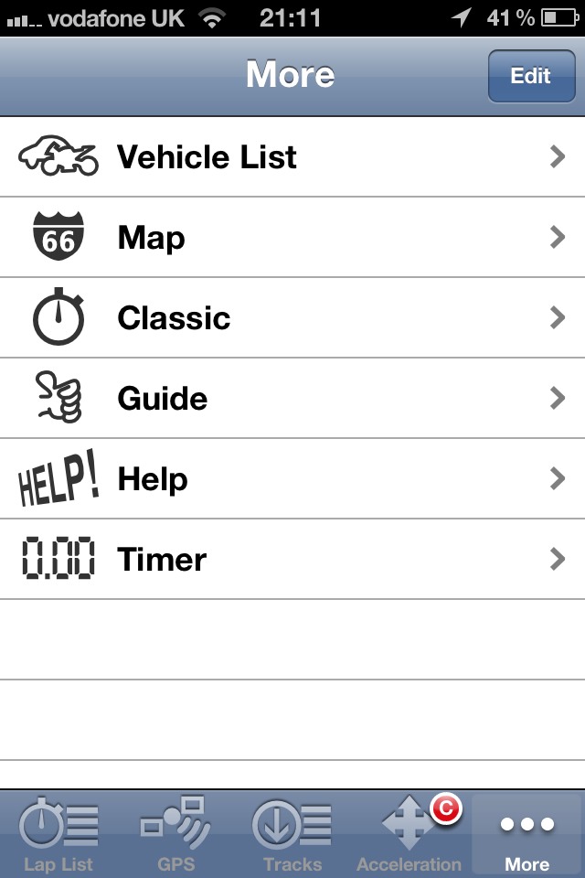

I appear to be having the same issue with lap timer using 2.0GB of space?
Video view has disappeared from 'More'
I have previously over laid the videos successfully.
I went to delete the videos but have lost 'Video view'??

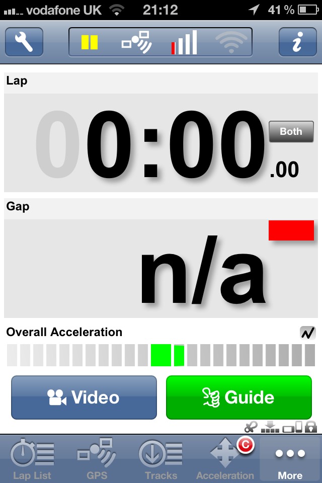

You have turned on Easy Mode (see the small pacifier in the bottom of the screen). To get the other views, select the Guide, select Define User, and turn on Advanced Mode again.
