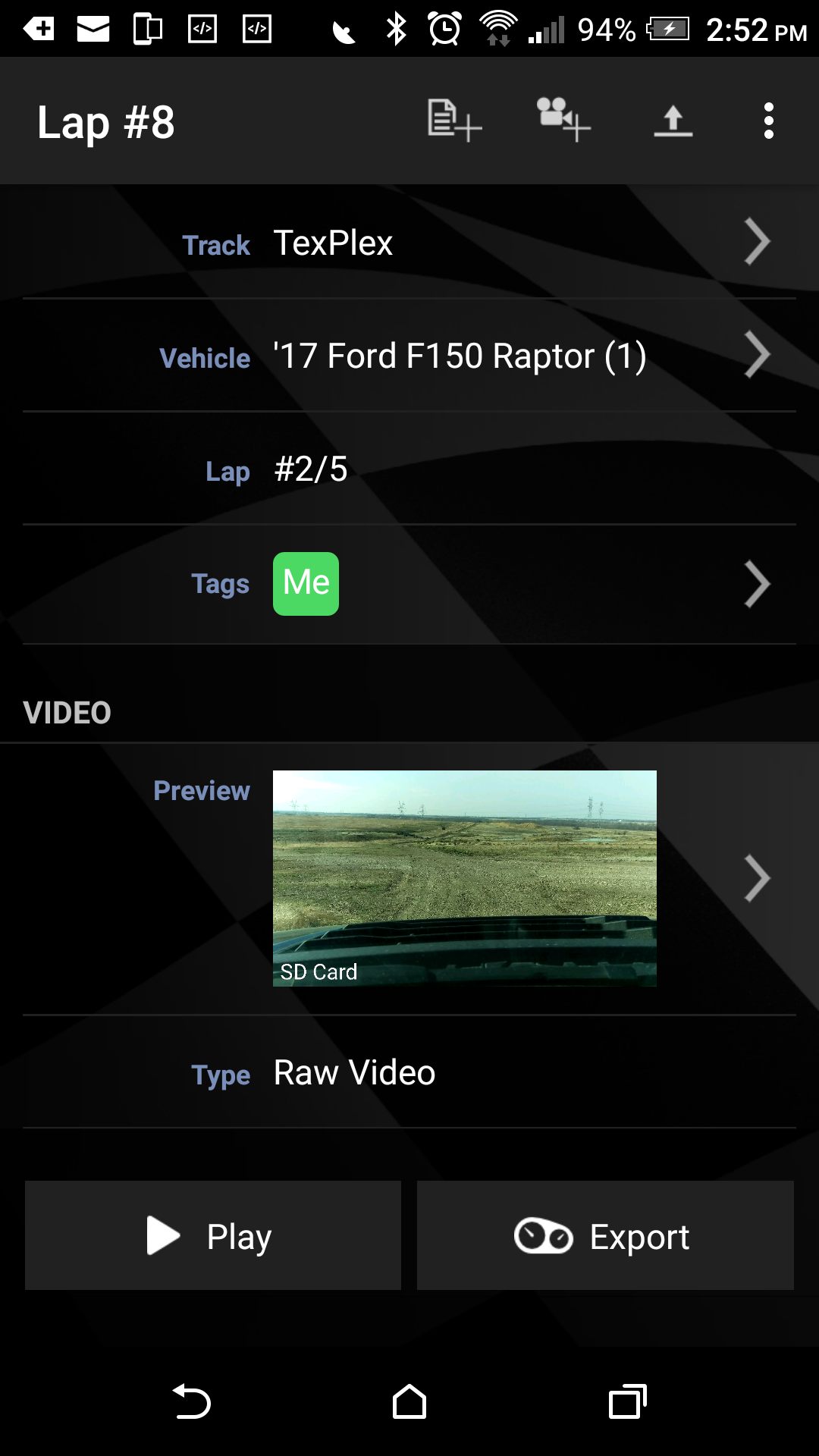

Re: OBD RPM Display gauge
Posted: Mon Feb 04, 2019 9:42 pm
by T4nkcommander

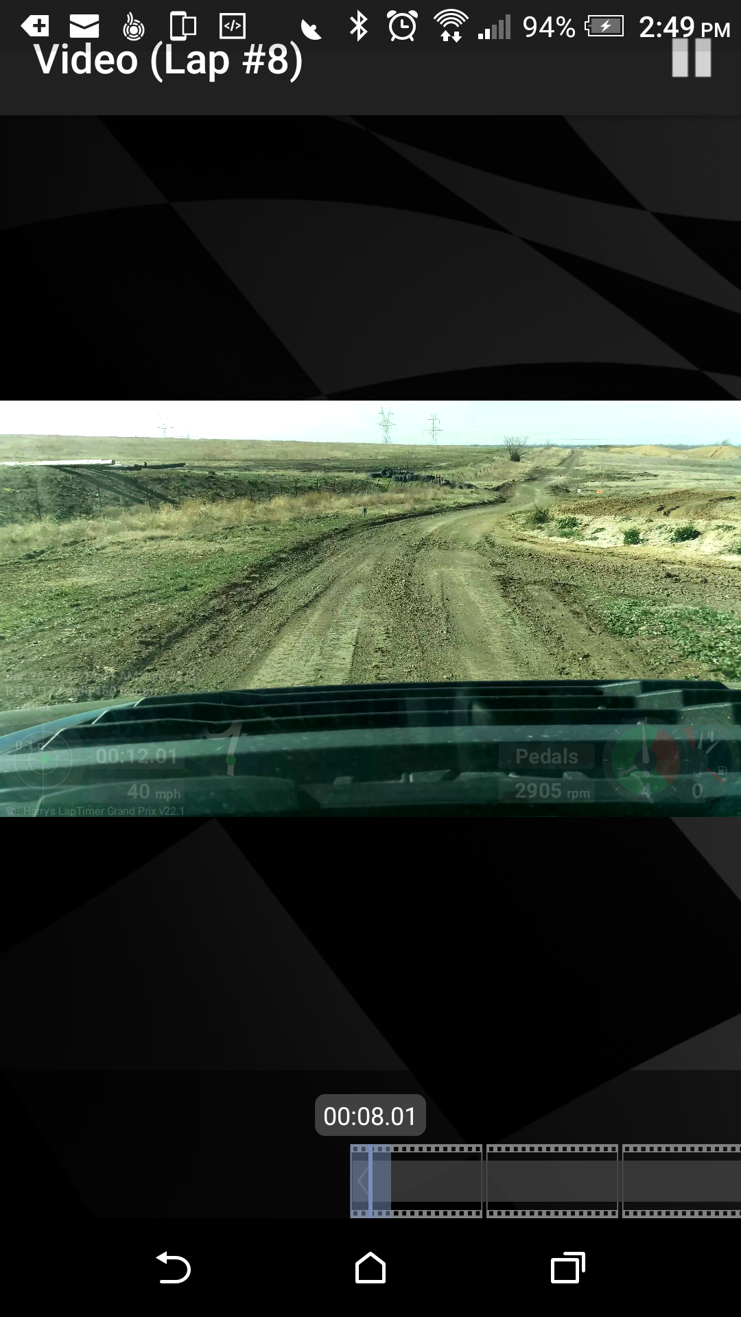

Hmm...still doing it on my end. After reverting and allowing the app to overlay on the fly, still same as before.
Any file or setting to change before re-installing the app?

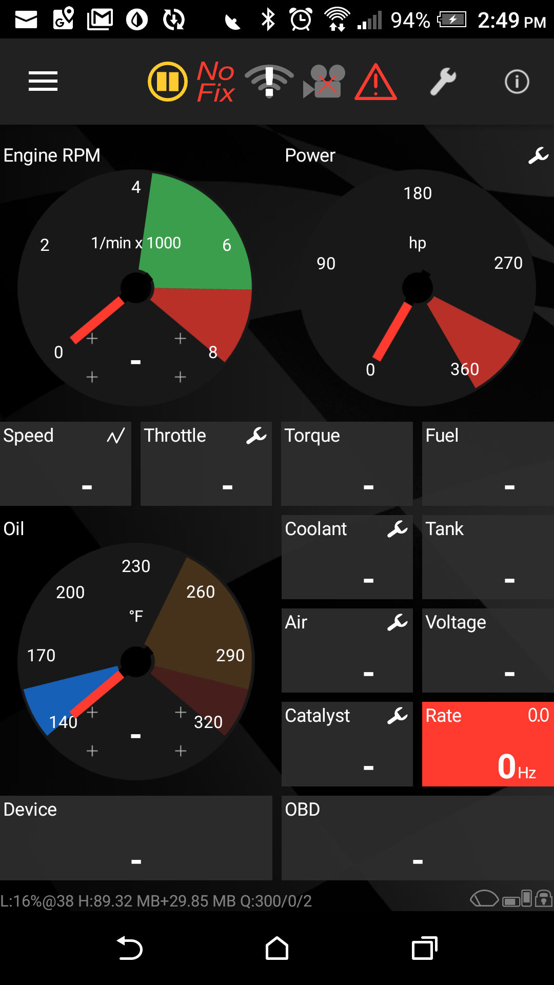

I've been playing around in settings. I think there is some bug in the vehicle created - because after making a duplicate and selecting the original, the engine tab gauge displayed incorrectly. Selecting the duplicate vehicle and going back to Engine shows correct tach, but trying to display raw video with either vehicle gives results as before. I suspect that these conflicting files are somehow causing the problem.
I'm going to try to delete the original vehicle and see if that works, or worst case, wipe the list and re-import the vehicle I sent you.

I purged all vehicles, verified the laps all went to 'unspecified vehicle', then re-imported the vehicle I sent to you. After relinking the vehicle to the laps associated with the trackday, I played the raw video and had the same problem.
Strongly considering doing a full reset of everything - or making a new vehicle from scratch - to see if I can resolve the issue. Probably will be this weekend when I have some free time.

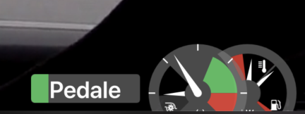

Well, I give up. Uninstalled and wiped everything, rebuilt my settings and vehicle from scratch. Went to do video preview prior to starting manual record, and same thing as before.
The only other thing I can think of that might fix it at this point is to adjust the max power values and rpm ranges, and see if that causes changes on the overlay. If it works or I find another fix I'll report back; otherwise I guess I'm just going to have to live with it.
