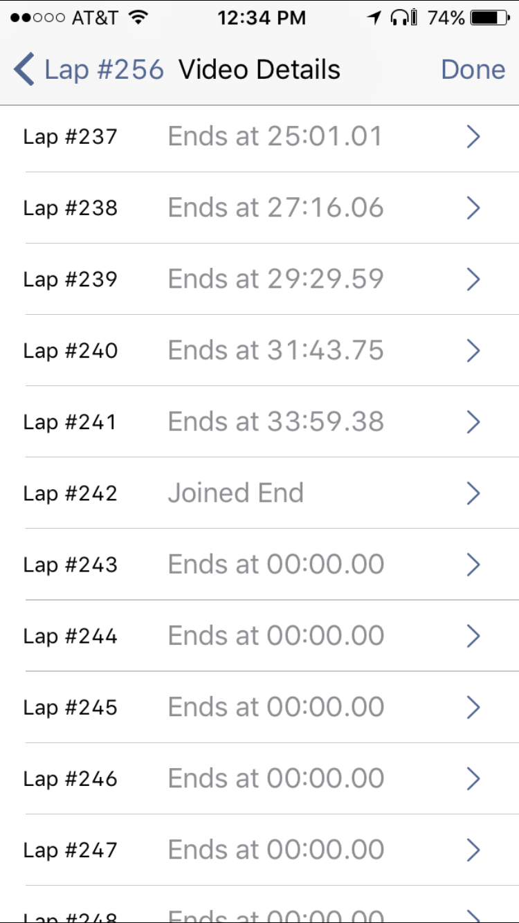

It looks like there is some issue internally with the app joining lap recordings. I noticed this when looking at the lap time sync view that the laps that don't render occur after mention of a "joined end":

Yes, as written in the other thread, I will investigate that for an upcoming bug fix release.

Brian54 wrote: Both sessions have been emailed to you.
Thanks Brian, I have been able to identify the issue.
It will be fixed for LapTimer v21.0.5 (both Android and iOS).

Existing sessions with more than 15 laps can be processed starting with version 21.0.5. Sync information between laps and session video is working fine for the production version. It is just that overlays are stopped after 15 laps and outer laps (starting with 16) will show up with an invalid zero sync point. NB: to use the long session overlay with v21.0.5, you need to revert any laps overlaid already. I.e. you need to return to the state you had just after recording.
