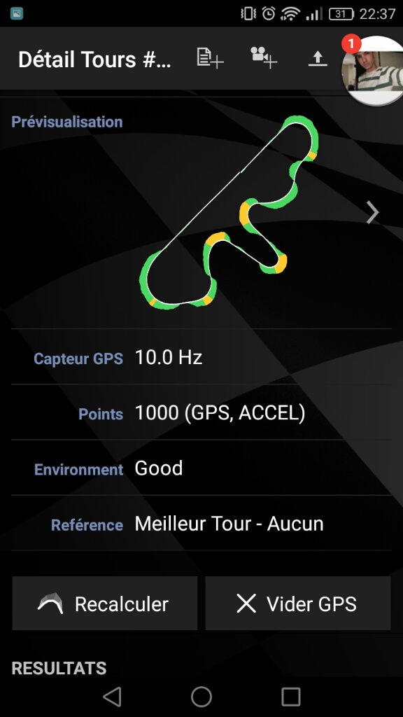

The problem is around the distance recorded - which is zero for all of your submission. This may be related to the track set used (not certified), or because laps are not stopped automatically but using a manual operation?
I don't know why !!!! All my track are certified, download in Extensions.
At the end of sessions, when i enter in pit zone, i click on "annulé" to stop the last lap, and stop GOPRO.

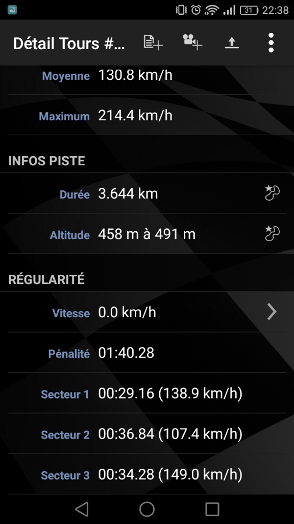

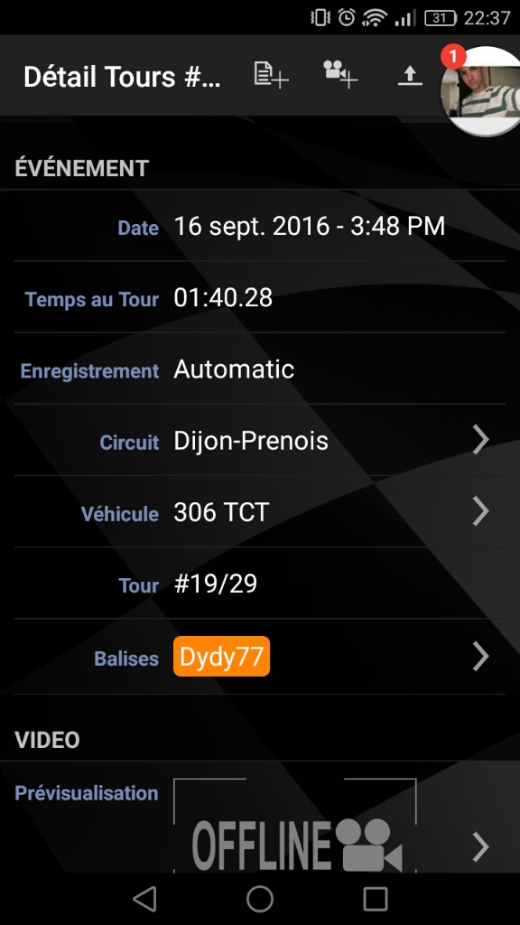

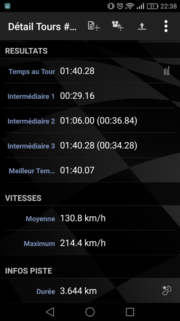

Please verify one lap you see in the list I sent: when selecting it from Lap List, do you see data recorded (verify number of fixes)? Does it show an overall distance?

For exemple the best lap : 1.40.28
016-09-16 13:50:24 +0000|1066|DYD|10028|306 TCT|0|1438861

O.k., looks fine. Please re-submit this exact lap using Hall of Fame and I will compare it to what arrives.
