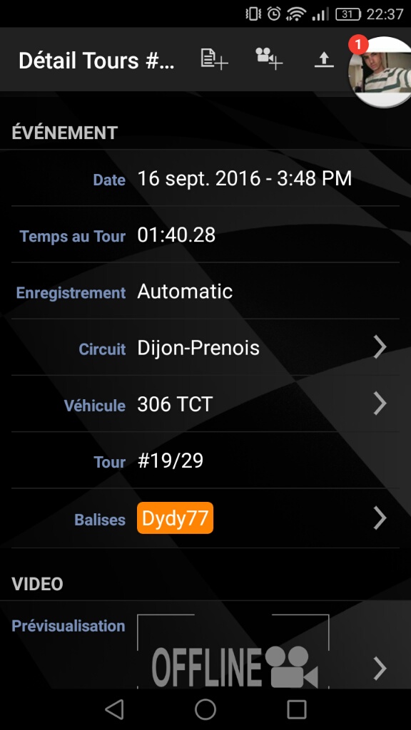

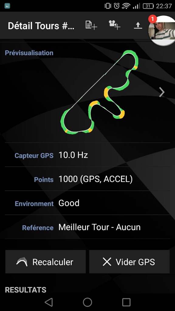

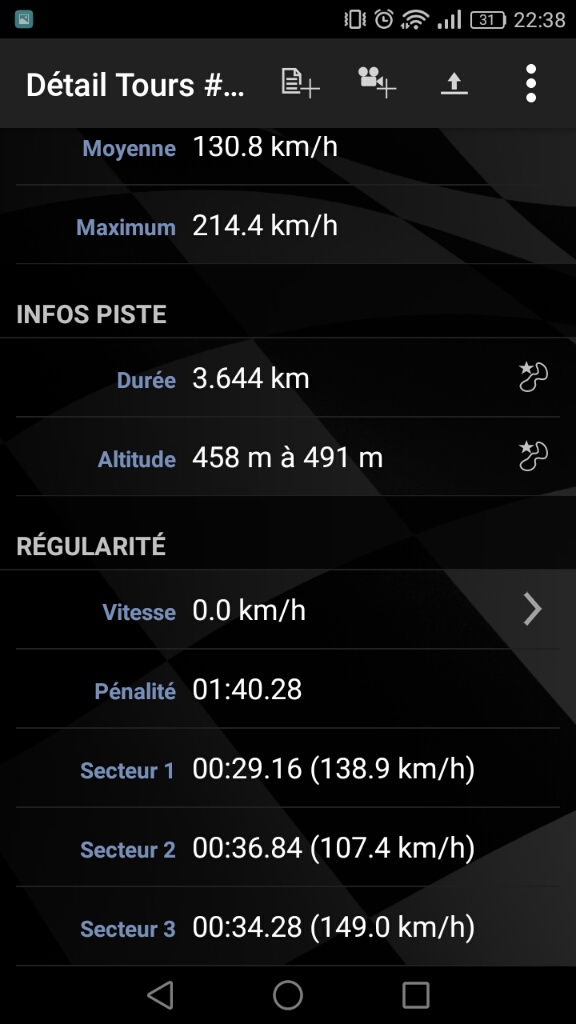

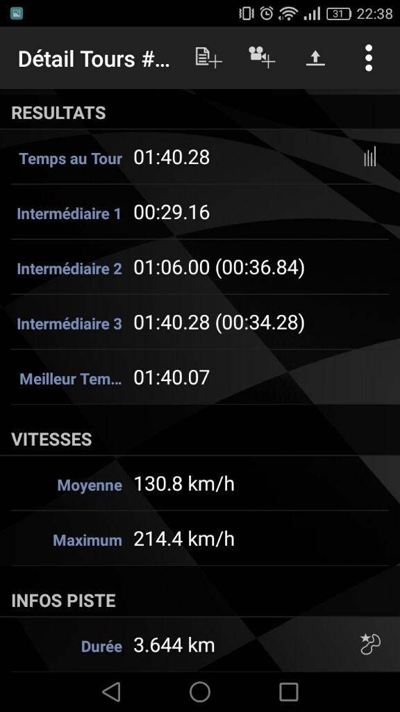

2016-09-16 13:50:24 +0000|1066|DYD|10028|306 TCT|0|1438861
The 3rd column is the lap time, 10028 e.g. means 100 seconds and 28 hundreds or 01:40.28
The problem is around the distance recorded - which is zero for all of your submission. This may be related to the track set used (not certified), or because laps are not stopped automatically but using a manual operation?
I don't know why !!!! All my track are certified, download in Extensions.
At the end of sessions, when i enter in pit zone, i click on "annulé" to stop the last lap, and stop GOPRO.
Re: Online Question
Please verify one lap you see in the list I sent: when selecting it from Lap List, do you see data recorded (verify number of fixes)? Does it show an overall distance?

For exemple the best lap : 1.40.28

Re: Online Question
O.k., looks fine. Please re-submit this exact lap using Hall of Fame and I will compare it to what arrives.
dydy77
Posts: 62
Joined: Sat May 30, 2015 11:41 pm
Re: Online Question
Post by dydy77 »
It is done Harry
Re: Online Question
Oddly, I could reproduce it with a Nexus 6. This will be fixed for LapTimer v20.1. I'm sorry for the inconvenience.
