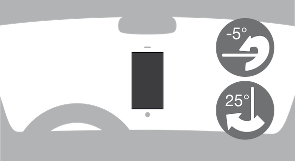

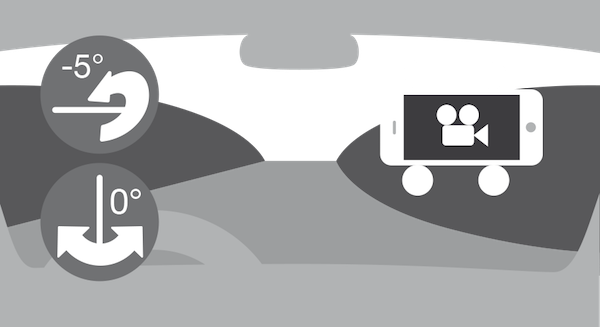

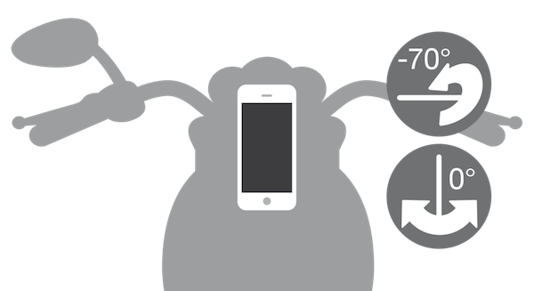

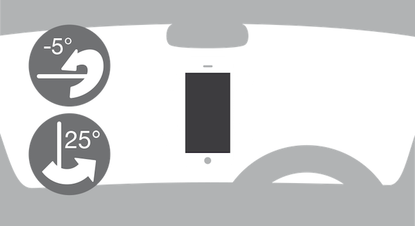

Please can you rework you documentation on orienting an iPhone. Using a GIF that turns every second isn't helpful individual photos would be better and no cost on the internet, would also make it easy to print out.
Also can you tell me if the car orientation will work on a motorcycle. I would like to use the phone to take video and it seems that the phone needs to be in landscape mode for this and your GIF only shows the motorcycle orientation in portrait is there a reason for this, lean angle perhaps?
I bought the GP version and will be testing it out at Donington on the 12th August for a motorcycle track day. :shock:
Re: LapTimer documentation
Posted: Fri Aug 02, 2019 11:47 am
Illustrations change every 3 seconds. ;-)
The orientations shown are relevant to get proper acceleration recordings. They are not required for general operation, you can ignore this altogether. For motorcycles, LapTimer needs to handle the lean effect (making lateral acceleration zero). So the orientation shown is the only one supported. In case you want to record videos, mount the smartphone in video orientation. You will need to calculate acceleration from GPS for laps recorded like this: select Lap List ‣ any lap ‣ Fixes ‣ second icon in the bottom ‣ Acceleration.
