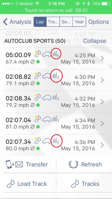

Could you please explain what this icon with different digits to the right mean?

Number of splits recorded the lap. This should be the same for all laps of a track. A strong variance means GPS accuracy is not great or the track set has splits set in difficult positions (e.g. after corners).
Try to recalculate the splits using a "Wide" corridor: select a lap, scroll down to Data Recordings and select Tecalculate / Splits.
