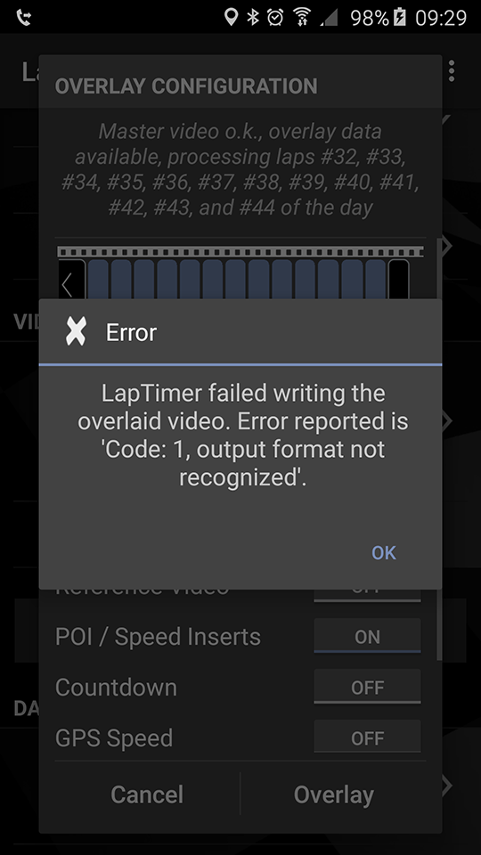

kimgrace
Posts: 16
Joined: Fri Apr 22, 2016 2:06 pm
Re: Help Galaxy S5 Neo
Post by kimgrace »
Tried again today, database corrupted, so I had to restore an older version...
Now I can't render, and still have the problem with having to re-launch the app every time I change a sync setting :-/
