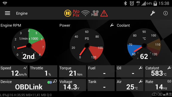

Re: Where to buy OBDlink MX BT in EU
So I tried it to change CAN Multi Requests ‣ 3 PIDs / adaptive. Update rate rised to almost stabile 14Hz (sometimes to 15Hz). But what I still dont understand is change of rate, I thought it was still same. For example: If I stay on traffic lights, rate in most cases drops to 2-4Hz, after I run up the car, rate after few moments rise to 12-14Hz.
Why this is happening? it's not very important, but I'm interested
In attachement is screen of improvement
- Screenshot_2016-04-29-15-38-56.png (57.53 KiB) Viewed 7081 times
2016 SEAT Leon CUPRA 290 ST
This is a real time measurement showing what is actually coming in. Response times for individual PIDs change depending on the general bus load. Like for any network, other traffic influences the throughput of a single service.
