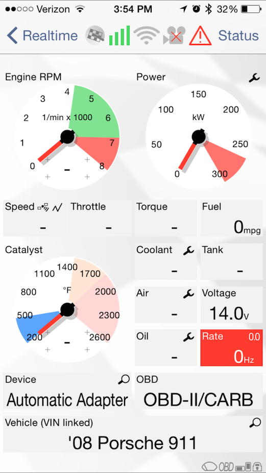

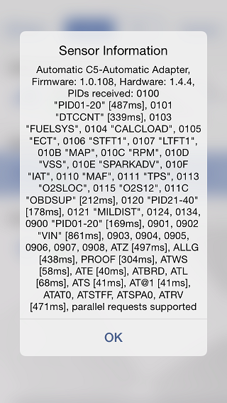

Still trying to work out the 0hz PID rate. Suggestions from Automatic were not successful. I am on the latest firmware for both Automatic gen 2 adapter and HLT Grand Prix.
Hopefully screen shots below help. As I also cannot authorize GSP/OBD Buddy, I can't follow the troubleshooting steps (Automatic authorization process keeps trying to connect to localhost. Clearing cache and re-loggin in did not help).
Please let me know if there is any other information that can help resolve this.

I just rechecked the app registration in Automatic's developer portal and the authorization redirect to localhost has not been set up correctly. I have adjusted it now - please try again. I don't know if there is some processing in-between, so maybe wait an hour or two.
The snapshots show LapTimer is not running the fill request cycle - which is the reason no valid PID set arrives and the rate is 0. We need to get the logging working, there is no other way to solve this for me.

Thanks for sending the log. I could identify the request which triggers an error and makes LapTimer disconnecting and connecting to the Automatic adapter constantly. I have passed the problem on to Automatic and assume they will be able to fix it soon.
In the meantime, you may try turning off Multi CAN request or exclude IAT from the PIDs requested. Enter "010F" (without quotes) into the Exclude PIDs expert setting to do the later.

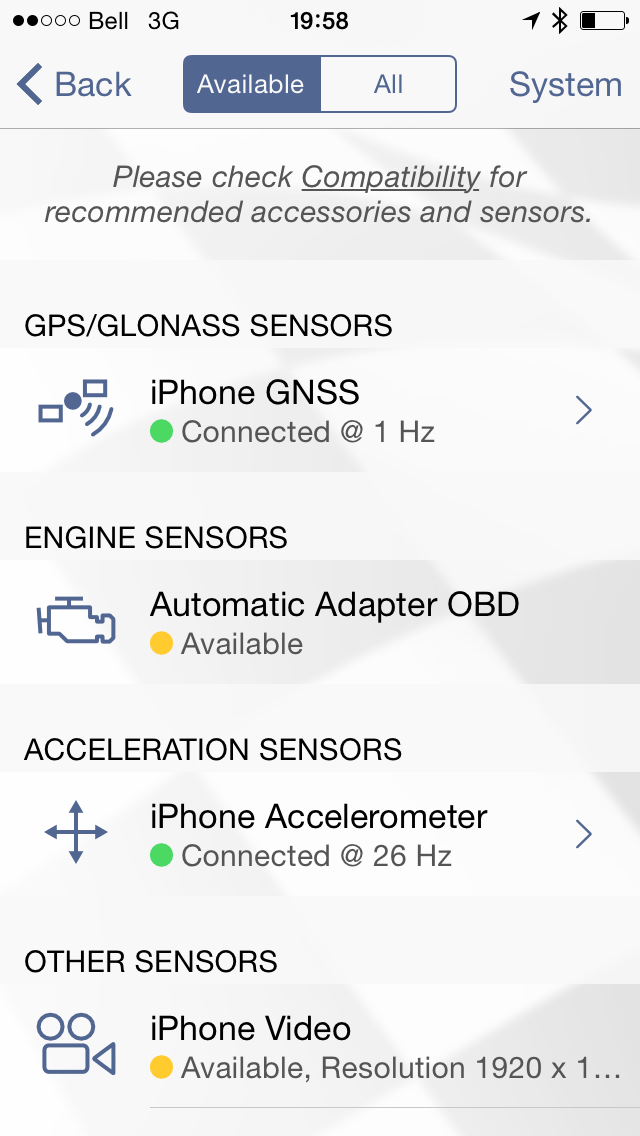

I was unsuccesful to link the Automatic G2 to laptimer on my 2004 RX8. The sensor list show it as available but Yellow image 1861. I got the automatic webpage and registered. I just got it once. Last weekend I was getting it everytime I was starting Laptimer... and sensor was always yellow.

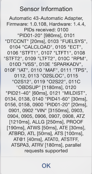

I was able to see the info on this sensor when corrected to that Subaru. see screen shots

The issue described in viewtopic.php?f=20&t=3143&start=10#p16201 is exactly the one you are facing. Your car is no CAN vehicle and needs the named workaround.
