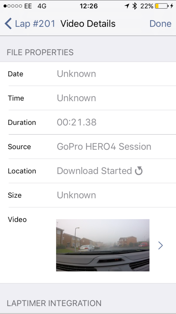

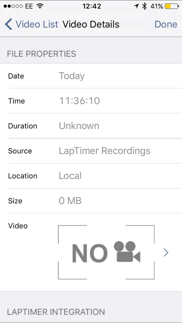

I've just tried and it works as you say. The video recording starts and stops automatically (as it did also in the Hero3/4 Setting). In Hero 4 Session setting it also wakes up the camera and then shuts it down when you leave the laptimer app. Re-open the app and it turns the camera back on again.
File transfer does not work. It gets further than it did on Hero3/Hero4 setting, it actually starts transferring the video and shows the correct thumbnail. It sometimes also shows a % transferred but then this just fails and it goes back to "OFFLINE". In video lists the video files are there just showing all as 1MB in the main summary, go into video details and they show 0MB.

The download is more an overall issue with the HERO integration than a HERO+ specific issue. The recommended way is to use either an SD card based transfer (on iOS you can use the Lightning SD Card Reader) or a copy using your desktop. A description is available in Video Documentation from LapTimer homepage.

I have that item on my list. The progress is not displayed correctly currently, so there is probably some space to improve on the LapTimer side too. The general reliability issue on the HERO side will not go away though.
