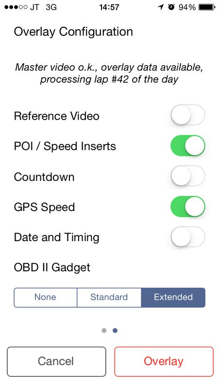

Re: Export video with overlay except lap time
these are the settingsxps911 wrote:You can make it compliant with the settings already available Eddie
- comply.jpg (41.34 KiB) Viewed 4027 times
