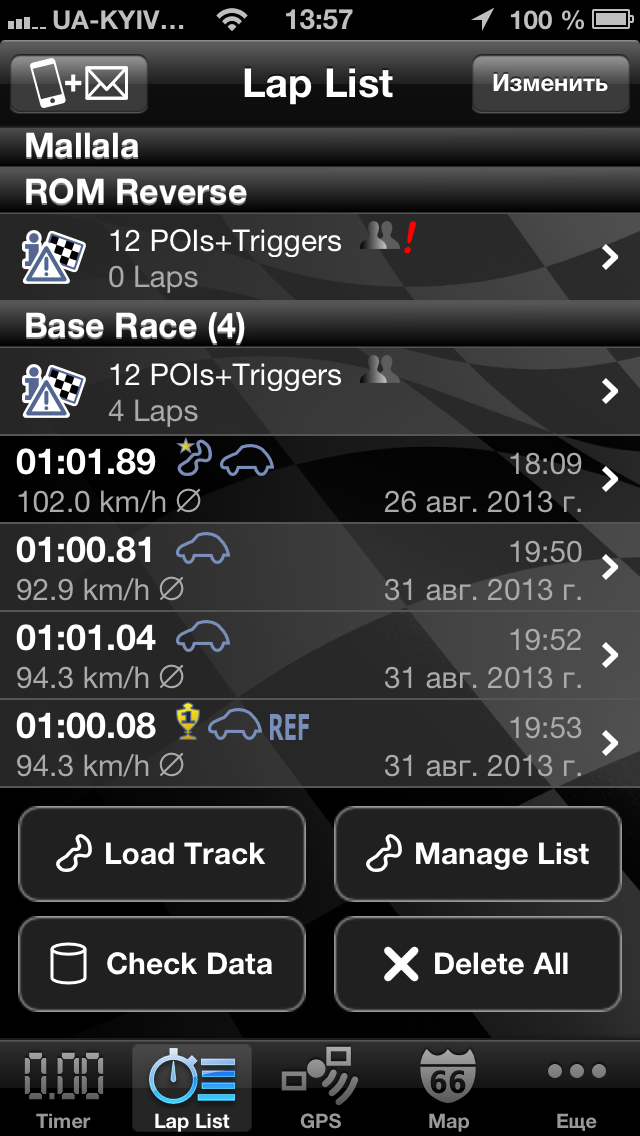

Hi Harry, after latest update v17.1.5, LapTimer has stopped recording Lap Data, custom track layout hasn't been changed, worked like a charm before.
I've recorded previous training sessions, worked fine, and yeasterday we had competition, I got Lap Time but no Track Data
Also could you please explain what is the "Set Speed" and "Penalty" ?

Re: [FAQ] LapTimer doesn't rec. / records several laps in 1
You have a Track Set conflict shown in the Lap List (red exclamation). Please make sure you clear the conflict by removing the conflicting track set or reload your current track set (and follow LapTimer's recommendation to purge conflicts).
