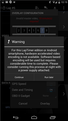

Event with only #7 selected?

Correct sir. I've attached the screen shots of the process.

Would not let me add a 4th. Here it is. After I click, nothing happens. The phone is plugged in as well.

Hi again,
I have just uploaded LapTimer v18.0.7 including a bunch of additional tracing to find out where the problem is. Please update to this version first, it should be available within an hour from now.
Afterward, please follow the instruction in this FAQ. The "trace classes" you need to enable for this case are "Video" and "Overlay". The operation to perform is simply to bring up the Overlay Configuration and press "Overlay". Once you are back (without message), please finish tracing as described in the FAQ. I hope I will be able to find the issue once I receive the log, thank you!

One addition: please run the "Check Data" function from Lap List before you start. This should fix the message on the " ... number of laps reduced ...".
