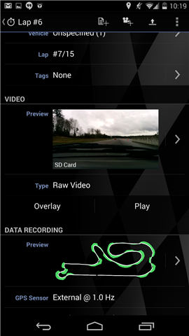

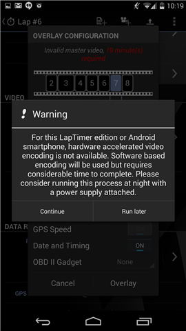

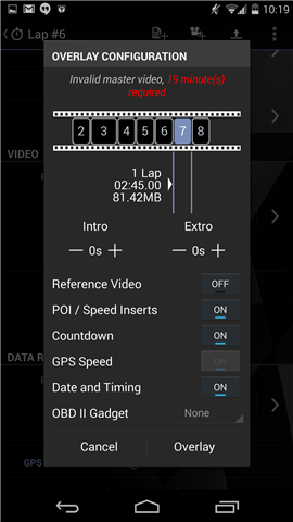

Correct sir. I've attached the screen shots of the process.
Screenshot_2014-04-08-10-19-40 (Small).png (76.68 KiB) Viewed 4359 times
Screenshot_2014-04-08-10-19-48 (Small).png (48.7 KiB) Viewed 4359 times
Screenshot_2014-04-08-10-19-55 (Small).png (44.84 KiB) Viewed 4359 times

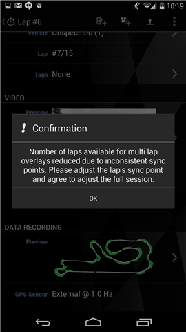

Would not let me add a 4th. Here it is. After I click, nothing happens. The phone is plugged in as well.
Screenshot_2014-04-08-10-20-01 (Small).png (50.32 KiB) Viewed 4359 times

One addition: please run the "Check Data" function from Lap List before you start. This should fix the message on the " ... number of laps reduced ...".
