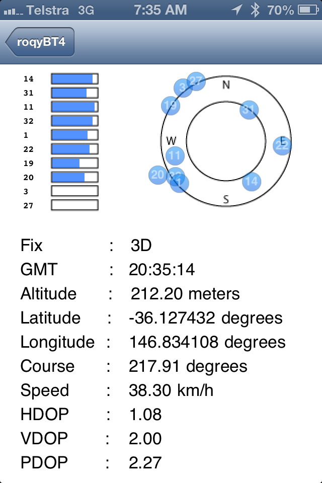

OK did some more testing on the way to work and it appears the issue is the conversation between Roqy and LT, see below.
This is the screen on Roqy that shows your device as working, I'm driving down my street at this point.
Roqy showing speed.
Roqy showing speed.

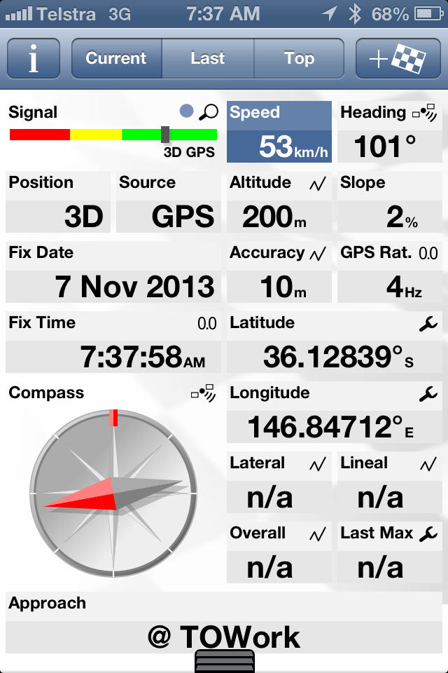

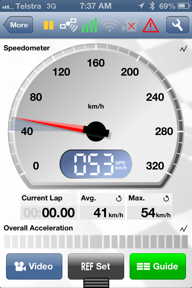

I then switched on LT and opened speedo view.
It moved to the current speed of the car but then would not move again from that point. As if it only took the initial speed reading from the GPS.
LT speedo view.
LT speedo view.

Here's the satellite screen showing greater than 1hz operation but still a static speed.

I then switched off bluetooth, Roqy and the gps receiver and let LT use the internal sensor which worked fine for the speedo.

I'm a bit surprised accuracy is 10m with the GPS receiver at 4hz and only 5m at 1hz, I'm assuming lower is better.
