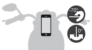

This means the device needs a tilt of 70 degree (90 degree would be flat). Both portrait or landscape orientation is fine. Please make sure your current vehicle has a "Motorbike" type set so LapTimer switches over to Motorbike Preset automatically (or set it directly in Settings).

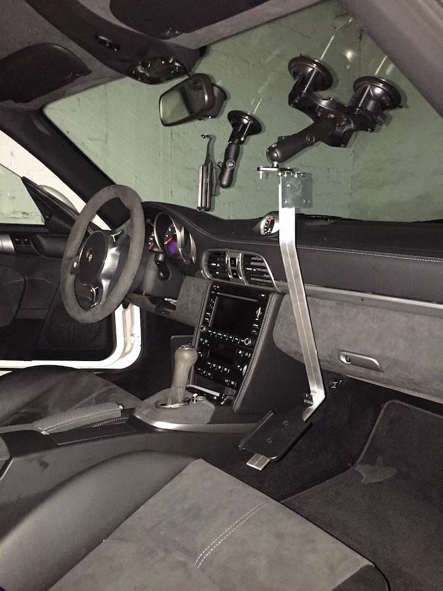

One more picture to show you the correct orientation to measure lean. This is the test construction I used during development.
IMG_5302 copy.JPG (162.11 KiB) Viewed 3241 times

In case the tilt is off, lateral / lean will be zero.

When selecting Motorbike Preset it is not calibrated. It simply expects to be mounted in a certain position (as discussed).

Sorry, I'm lost. Select Motorbike Preset and mount the device in the position expected. This will allow LapTimer to record valid data on a motorbike.

Calibration is one approach to find a correct setting, a Preset is the other. Please don't mix that up. If you get a lean in the center of the corner only - probably where you have most lean, this is a clear signal the device is not at 0 acceleration while standing still (i.e. you do not have it mounted at 70 degree tilt). You can verify you have the correct angle by mounting the device and have a look into the acceleration shown while standing still. If lateral and lineal is 0 (+-0.05), you are at 70 degree. In case you have more, adjust the angle.
