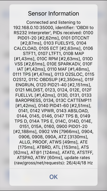

What is the current 2017 status for showing oil temp on a BRZ/FR-S/GT-86? I just bought the Petrolhead edition and don't see oil temp. I'm using a Veepeak OBD2 Wi-Fi device with an iPhone 6 Plus. Could it be the Veepeak device isn't sending the PID? Do I need the Grand Prix edition to see oil temp? OBD2 readout attached. Thanks.
The PID 015C is missing - which means oil temperature is not mapped to your car's OBD port. In case a car manufacturer does not support the mapping, only custom PIDs can be a work around. These however are not yet supported by LapTimer. Even worse, these PIDs are by car / model and kept secret by car manufacturers.

Been using HLT for 2.5years now mainly for timer during my HPDE days, now im doing TT for EMRAracing.org and somewhat getting serious tracking my car, wanted to link up my oil temperature. I have gopoint odb bluetooth, and attached the sensor list, how come my oil temperature doesnt want to show up.
https://i.imgur.com/mYfCkgd.png
Your car does not provide oil temperature using the standard OBD PID (015C). You get engine coolant, catalyst, and intake air temperatures, but not oil.
