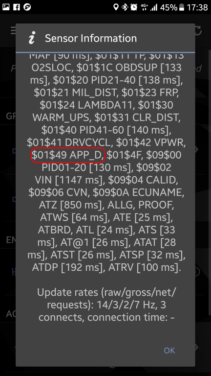

Im not a programer, but if I checked sensor list, I see this. So, OBD can read PID "D" from car, but app shows nothing

Re: OBDII Throttle position display meter
This means the ECU responds to AppD. This does not mean your Skoda delivers anything useful. In addition, at least for the point in time you created the snapshot, LapTimer didn’t use AppD but some other PID. PIDs actually requested will show a response time in brackets.
When changing an Expert Setting, it is a good idea to refresh the sensor from Sensor List, this will restart all sensor integration and use the changed settings.
In case you want to see what your Skoda actually responds, you can trace the dialog. See “Debugging OBD Connections” in the FAQ section.
