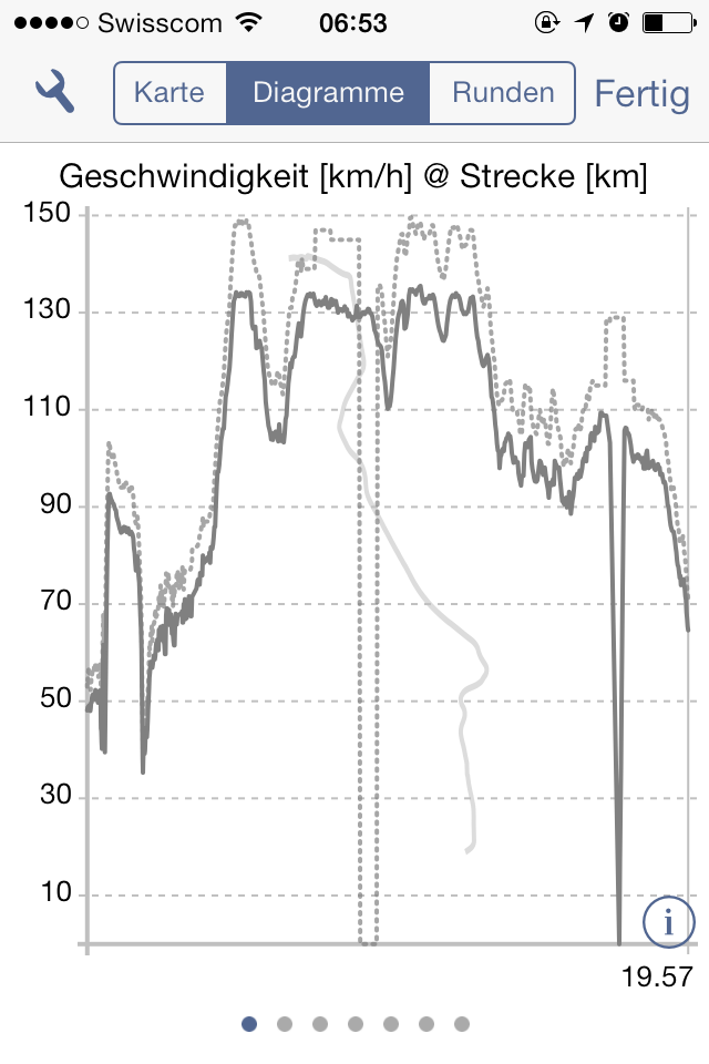

I've done yet another try using lower video rates. I'm not giving up easily.
Despite the fact the video is not useful at this resolution when rendered (lot's of information missing as it is cut off from the screen), I did not find a prove the video rate would have an impact to the durability of the recordings.
I first ran a test with "Wifi" resolution. That looked promising in the beginning, but I then faced 30+ seconds drop out during the middle of a 12 minute recording, and another short one later on (see IMG_7728). Still it was better than that with higher resolutions.
But when I was going to the ultimate "3G" resolution, picture looked even worse than before (seeIMG_7730). Have a look not only where it dropped out but also where the graph is going flat horizontal whereas the native GPS measurement is vibrating.
Going to test without video next week.
I'm not 100% confident this is an iPhone 4 video rate issue purely, as 1) it used to work fine before with earlier versions of LapTimer and 2) there is no ratio interpolation of video rates used compared to dropout occurrence visible to me. Still the iOS7 thing might factor in, but probably not the video rate as such.
