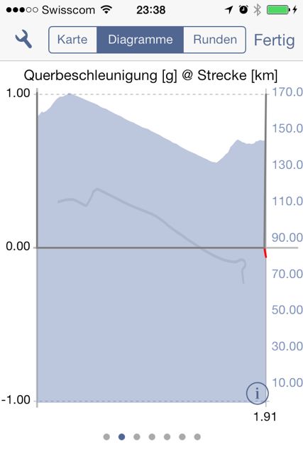

- lateral acceleration
- IMG_7576.jpg (31.14 KiB) Viewed 5382 times

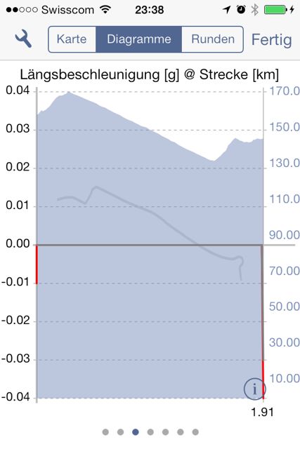

- sidewise acceleration
- IMG_7575.jpg (25.86 KiB) Viewed 5382 times

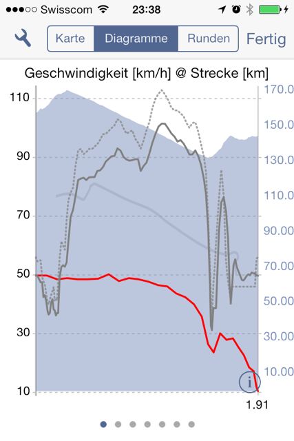

- speed graph
- IMG_7574.jpg (33.96 KiB) Viewed 5382 times

Happy to hear. On acceleration: except there is something very strange going on, I'd assume the missing acceleration is related to the usual issue with missing calibration while standing still. This however would mean you do not get it displayed in real time either...
Re: Trouble with GoPoint BT1 and Harrys pro
You are right. Calibrated and it worked fine. Thanks!
