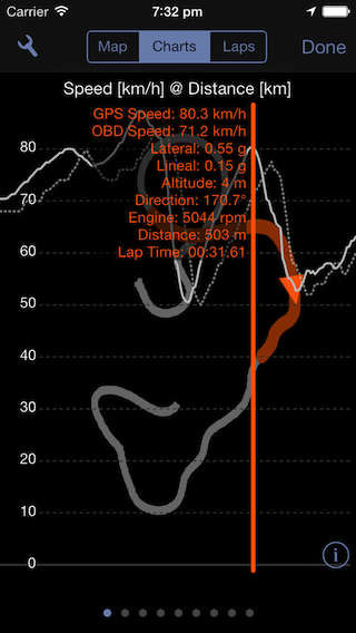

In Grand Prix a cursor is available to see the details, I choose one peek:
iOS Simulator Screen shot 18.09.2013 19.32.42.png (96.72 KiB) Viewed 11033 times
and the corresponding peek for OBD
iOS Simulator Screen shot 18.09.2013 19.32.47.png (96.35 KiB) Viewed 11033 times
Time gap is 0.7 seconds and OBD is late... This means you need to increase the OBD delay as it is obviously coming in with a bigger delay than expected (0.5s). So setting "Any OBD" to 1.2 will do the job for the next recording. As an alternative, you can decrease GPS delay - which is my recommendation as the XGPS's default is 0.7 anyway. So any OBD = 0.5s and XGPS = 1.5-0.7 = 0.8 should be fine.
