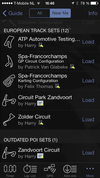

Since HLT knows where you are, could the top of the "tracks" list be "nearby" tracks showing the track possibilities at your location. Further, some tracks have multiple configurations and some people don't select the correct track, then upload improbable Hall of Fame times since they are really on the short course, not a long version. Maybe is a POI is never crossed, HLT might suggest you select the proper track.
Use the M7 chip to reduce power consumption?
Favorite app. Great work Harry!
Re: Usability Suggestions for LapTimer v17.5
Probably something like this ;-) You can find my position using triangulation :-)
