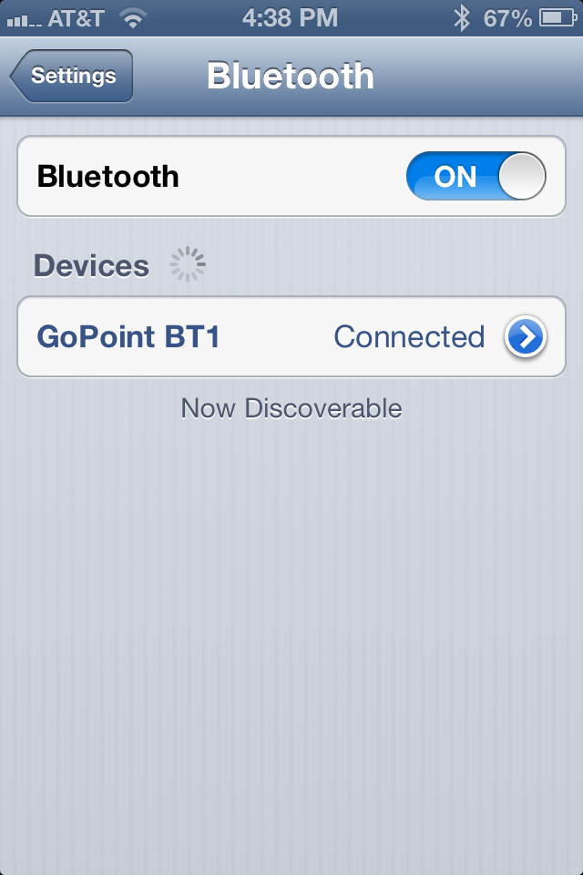

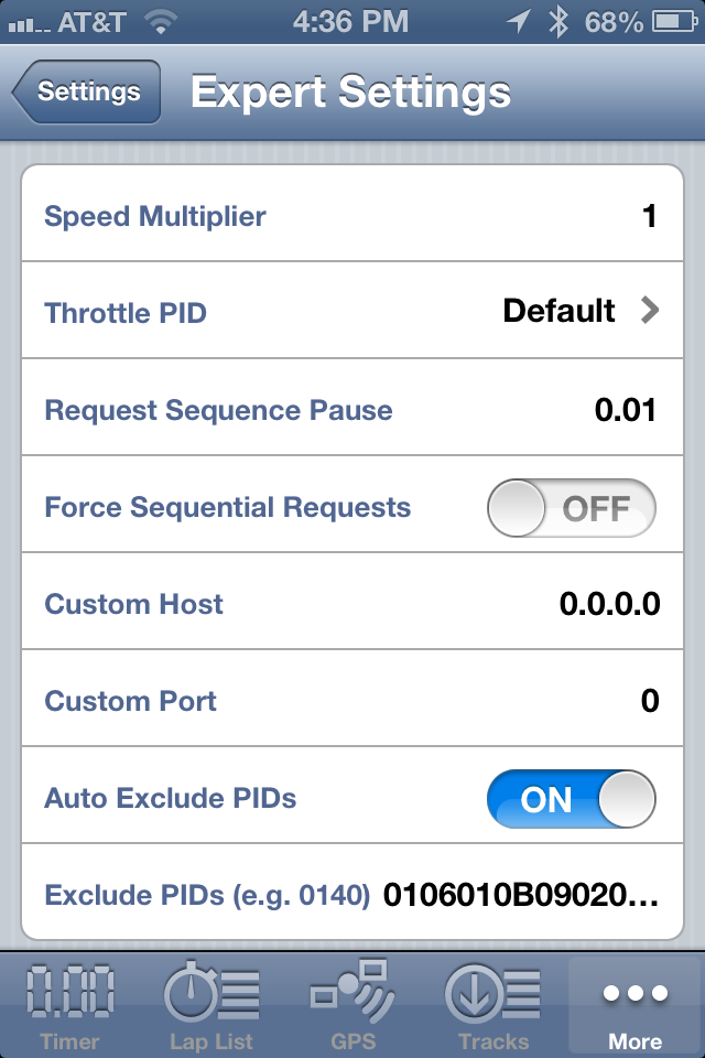

I have a few screen shots to show you. I eventually got the BT1 to pair to my Iphone 4. It works with my Mercedes S430 as it should.
It still won't work with my 2004 BMW M3 with a stock S54 engine. Here are the screen shots. If you have any final recommendations or ideas I would welcome them. I did send off several inquiries to the Hamilton folks for troubleshooting. However, they won't even answer me now.

Please give us some more days, I work with several other BMW drivers to find a solution for this. It is pretty difficult as I do not have a BMW car around for testing. So it is always a long ping pong to generate logs / adjust the code and test again.

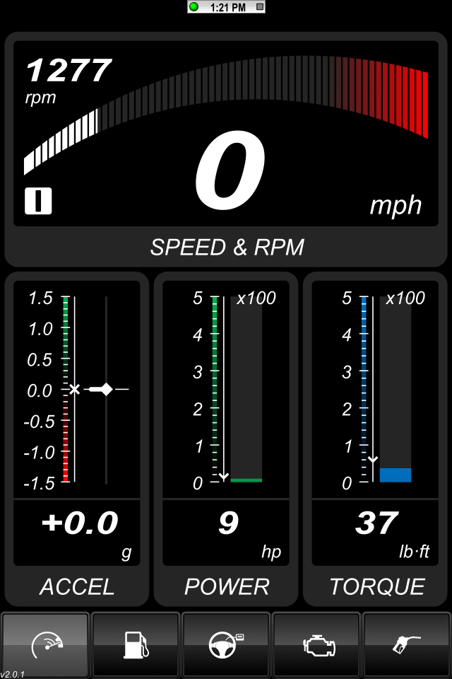

I think the problem is now solved. Many thanks to you Harry and the BT1 team. Success for the S54.

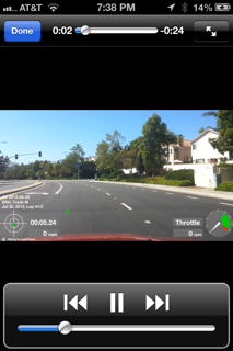

Next issue:
I tried out a sample video recording. I took a snap shot of the playback to show the problem. When I choose overlay, the phone seems to try to do a video overlay. However, during playback, the actual data is not presented. You can see there is a throttle sensor and other parameters, just no data.
Help !
Help !
- no data II.PNG (55.37 KiB) Viewed 6698 times
Re: BMW vrs GoPoint BT1
Please check your recordings (especially GPS). There are no known issues with the overlay, but missing data due to missing quality data from GPS and OBD is a frequent issue. So please enter the Lap's Details and verify the data: follow the preview row and flip through the charts to understand what data is available and which is not. In case you cannot find the issue yourself, please consider either opening a new thread or switch to email. We need to stay on topic here
